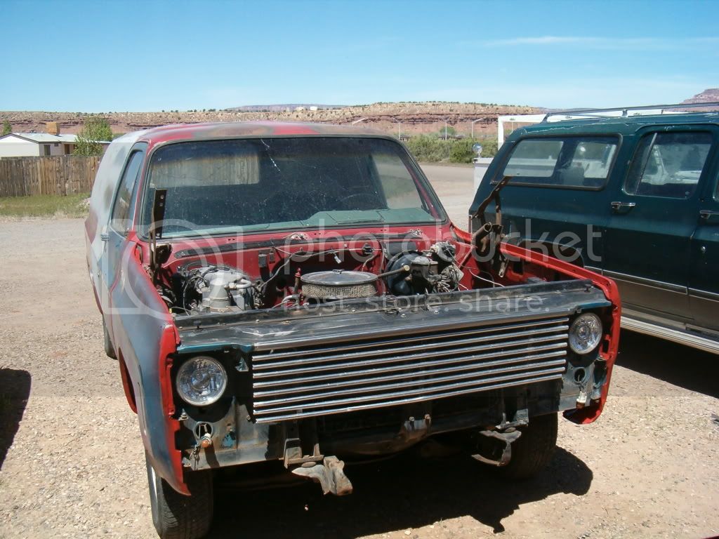

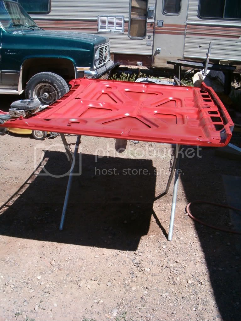

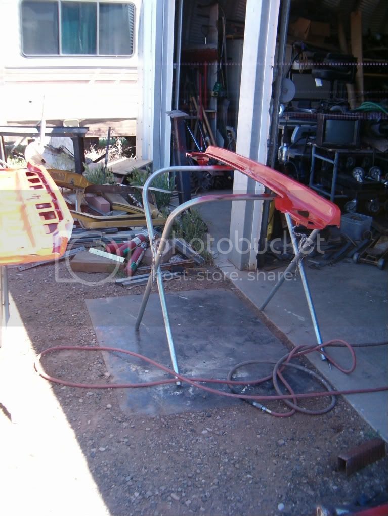

here's a couple of examples of what I mean.
Fenders jammed and installed.
Hood Jammed waiting to be installed.
Lower valance jammed.
I made the stands from 2 1" 10 ft pieces steel of electrical conduit, not to hard to make.
