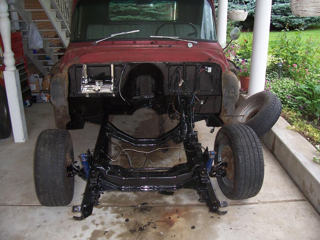

What I did this summer.
As a teacher with no garage in the middle of the "greatest snow on earth" (at least that's what the tourist brochures say), I have to do most of my work on my truck in the summer. This summer I removed the tired old 327 the previous owner of my truck had in it and replaced it with a 350. At the same time I took out the old truck 4 speed with the Granny first gear and replaced it with a sweet shifting 5 speed overdrive transmission.
First picture is the before. I painted the front part of the frame with PUR 15 along with the inner fenders and the fire wall. I'm still working on figuring out how to best route the wires and hoses to make the engine compartment not look so cluttered, but she runs sweet and shifts sweet. I'm getting the rear end rebuilt in the next few weeks then the drive train will be new from fan to axles. The rest of the truck still looks kinda ugly, but I'll get there. Stan |

You make it sound like removing the front clip is easy. What is the best way to take the front sheet metal off as you did? Did you remove it all as one unit or did you take each fender off etc. I would like to remove my front clip to get things cleaned up on my truck but I don't really want to undo each individual part.

Removing the front sheetmetal
is not really a big job. Take the hood off. Take off the hood springs(this can be a bit of a trick, I used vise grips and a big screwdriver.)Take out the bolts holding the hood hinges to the inner fender. Remove bolts at the top back of each fender, the bottom back of each fender, the fender braces and a tab on the firewall on each side holding the inner fender. Two big bolts at the bottom of the radiator/grill support hold it to the frame, get those out. Drain your radiator and disconect the hoses. Unplug the wires that are connected to the fenders. One plug at the firewall did this for me. Get a couple of your buddies to help you lift the whole kit and kaboodle up and off. I pulled my off myself, but I wasn't worried about scratching paint when I took it off. I think it took me about 1/2 hour. I was really kinda suprised how few bolts were actually holding the whole mess on.
I attached a picture of my front clip removed. Arrows point to the spots where the bolts are. I didn't put arrows on the fender brace locations. Stan |
