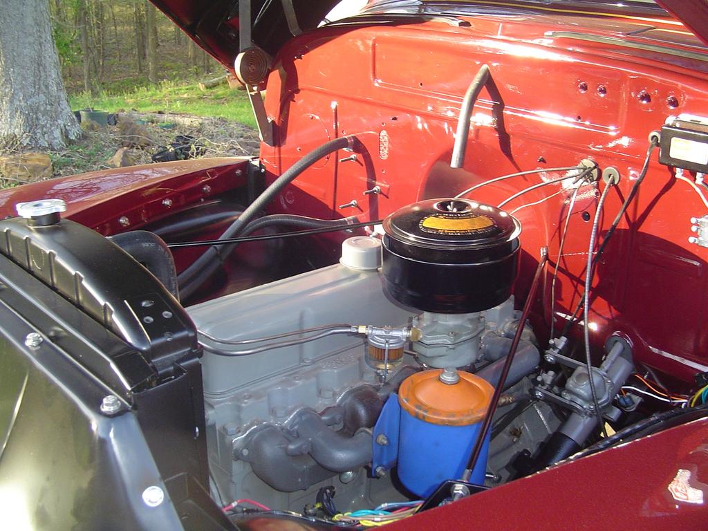

workri's photo site shows the bypass type filter. It is usually mounted on the intake manifold with two u-bolts and a bracket. Here is a shot of a full flow filter that is usually mounted at the lower left rear of the block.

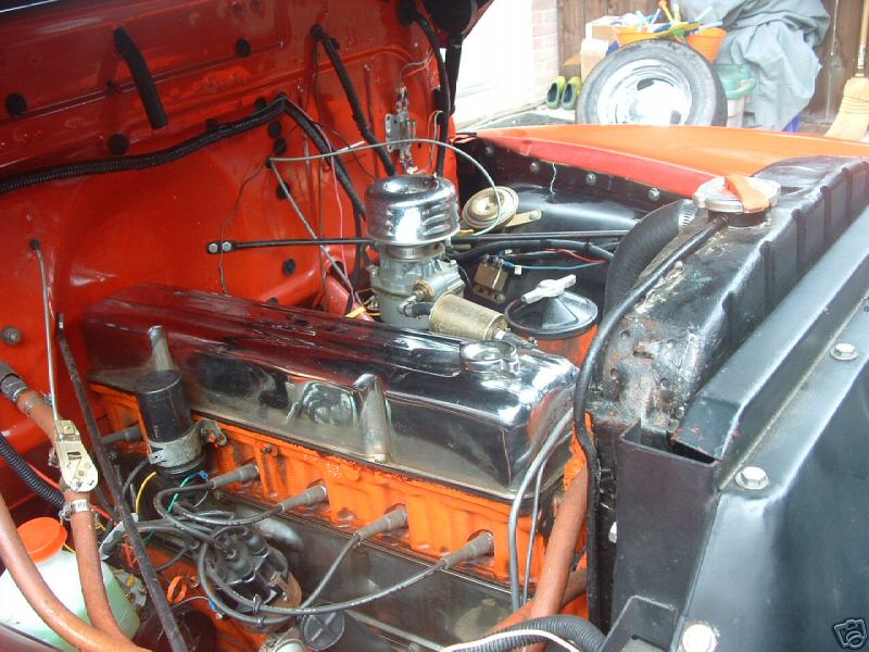

Here's another example of how a by-pass filter can be mounted. In this picture, you can see the U-bolts that Flashlight was talking about.

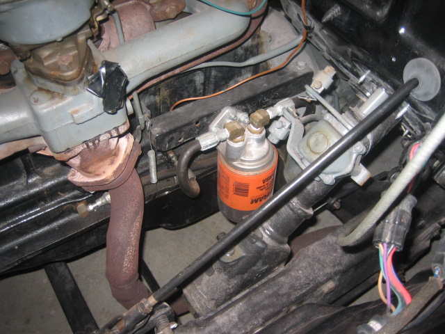

I meant to say I wanted the spin on kind that Evan pictured. But Nate poses the question full flow or bypass. I dont know but it is a 1962 engine 261ci. The inlet and outlet on the engine for the oil lines look like 1/2" NPT thread.
I have a picture of the engine's filter mounted on the exhaust manifold. I have no idea if it is the proper one. This engine went ~6,000-miles showing 60-psi cold and hot. Engine was stopped, it did not lock up. The engine was sent to AGAP in Austin TX & should be back Friday.
Thanks

So , why not re-use it ? . that appears to be an old FRAM unit .

It is Fram in exclent condition.
Quote:
I expect that newer spin-on's make a finer cut. They are a little cleaner to change & easy to buy across counter. After break-in I plan to use Royal Purple & a K&N filter.
