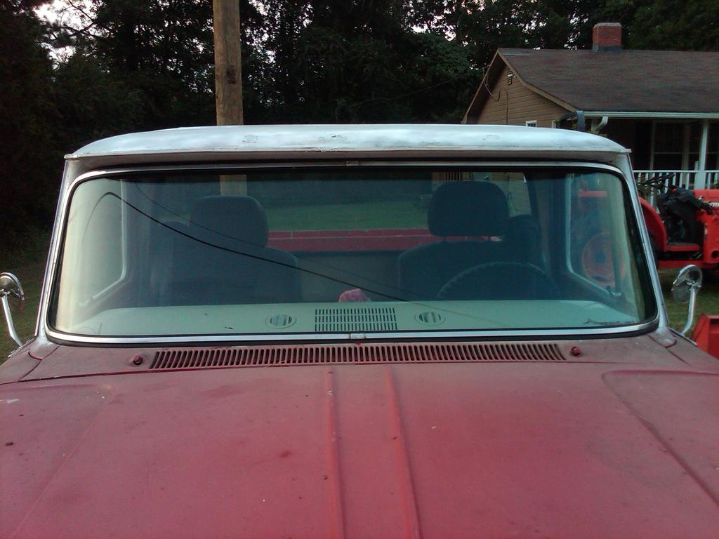

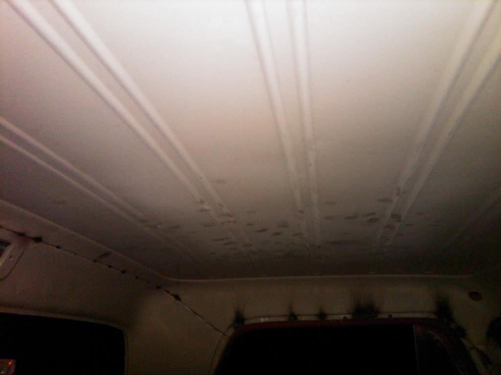

finally: the end of the sunroof chapter
Whew!, Alright guys, I was on vacation last week and did the roof swap on my truck. It was averaging 98-100 degrees outside, so it took me about all week to finish it, but after about 60 bottles of water, 2 boxes of bandaids and 4 spot weld cutters it's finally done...with the exception of the glass
If anyone is interested in how I did it, I basically:
1) removed the outer roof from the donor cab by cutting all the spotwelds
2) removed the inner panel from the donor by cutting all the spotwelds
3) removed the windshield and back window from my cab
4) removed the outer and inner roof from my cab
5) painted the underside of the outer roof and upper side of the inner roof
6) clamped, welded, seam-sealed the inner panel to my truck
7) put sound insulation between the two pieces
8) clamped, welded, seam-sealed the outer roof panel
9) sprayed some rattle can paint to old off the rust till it cools off
10) sat on the couch in the air conditioner with a cold beer for the rest of the week
I tried to install the glass myself, but quickly gave up and will farm it out to the pro's.
I didn't take very many pics, but here are a few:

Nice work , be careful welding it out so you don't get it tooooooooo hot. Skip around and keep it cool....Big Tim

in addition, a spray bottle or wet rag will also help to instantly cool the joints and keep warping to a minimum
wow, that is a huge accomplishment. Glad to hear there were a few beers in the mix to keep the patience in tact!
would like to see more pictures... outside, inside, front, back.

Thanks for the compliments, this was definitely the largest undertaking I have ever taken as far as body work is concerned. I was a little worried at the "point of no return" when both cabs had the roofs out.
Beer did help, but there wasn't enough beer in the cooler to keep my patience for the windshield/ rear window installs though... Oh well, can't win them all huh?
I'll try to take some more pics tomorrow if the weather cooperates.

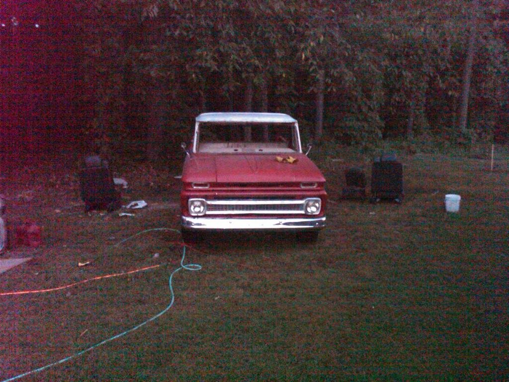

Glass is in/Pics
OK, I had a team come put my windshield and my back glass in this week....better them than me.
here are some pics of how it sets now.

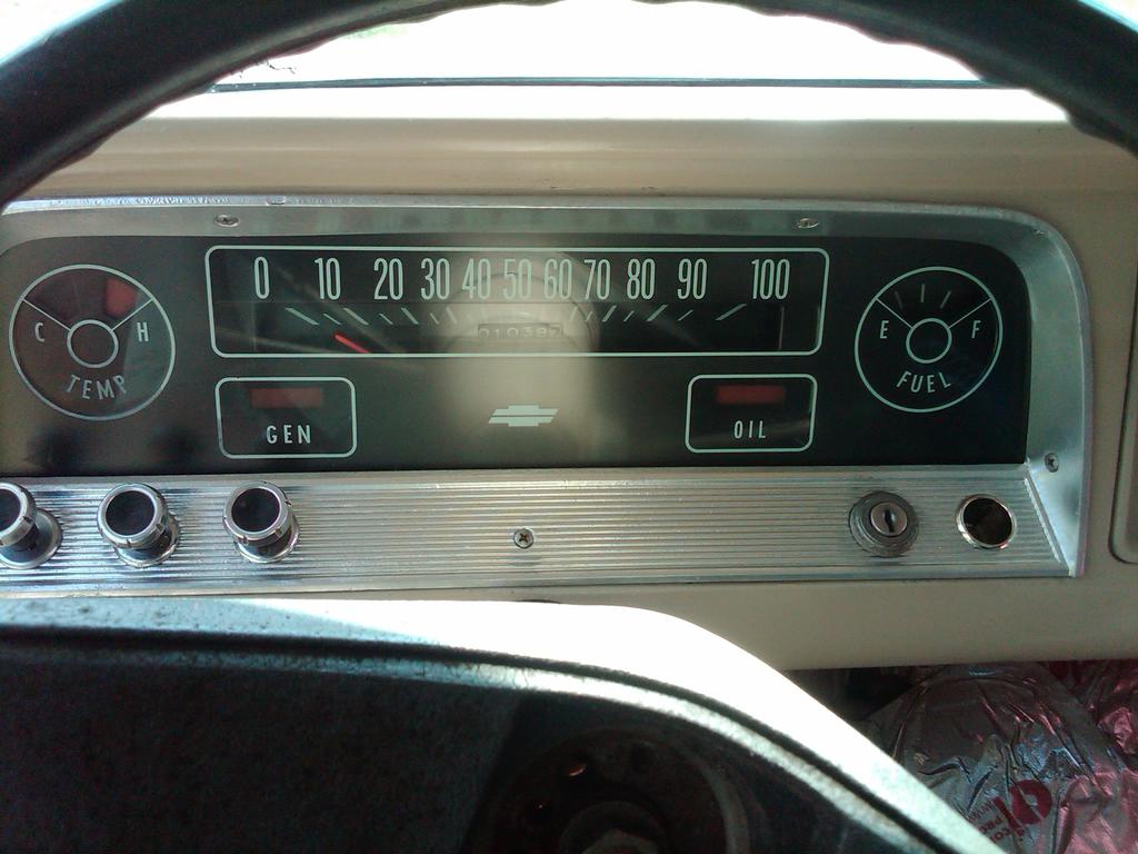

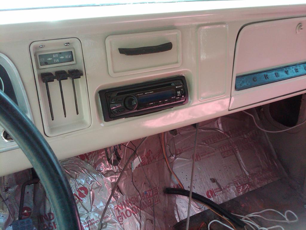

Is that windshield rubber stock? I've never seen one with chrome trim embeded like that.
Your interior is also coming along nicely, I'm sure that sound deadener will help out... my truck is loud without it! hopefully next summer
are you going to stick with the dummy light package or look for a deluxe insert with guages intead?
