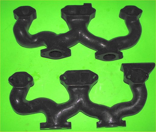

We have a pair of cast iron Fenton "Black Widows" for Small Block Chevies that should work.

fenton black widows
Theres a guy in Ca. that has a pair of those for sale. Saw them on e-bay recently.

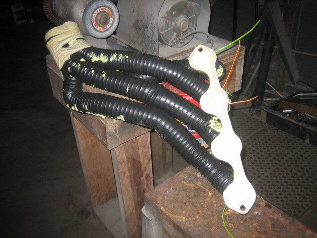

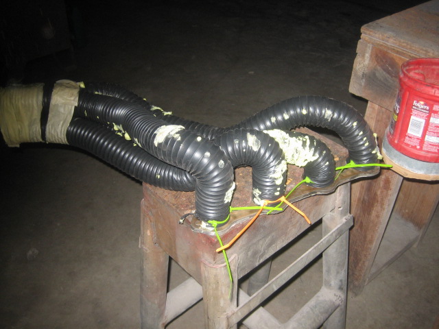

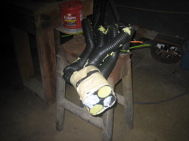

There is a shop in (or nearby) Moorehead, Minnesota that will send you a kit to mock-up headers that will clear everything and then you send this to them and they will build a set that is EXACTLY like the mock-up. The surprising part is the total cost is in line with any other quality header. Not knowing they existed when we needed headers for a 57 Studebaker Golden Hawk we went to a lot of time and expense to mock up a set using defroster duct and styrofoam to give them rigidity. Just made up some flanges with 1" of tubing tacked to them for a place to clamp the defroster duct and taped the tubes together at the collector end. The styrofoam spots on the ducts are bleed holes to let the air escape when shooting the foam in from the ends. The headers made from these patterns fit like a glove. If there is any interest I will go back through paper work and try to come up with a name.
