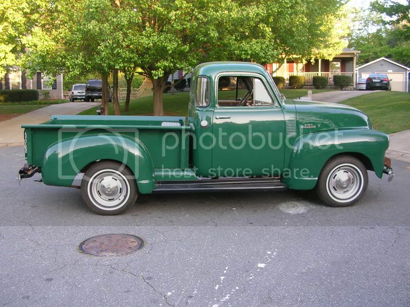

  6. ol' chebby
    3,164
    3/4 ton....3600
    1/2 ton..3100
    Also, the 3/4 ton will have 8 lug wheels, 1/2 ton is 6 lugs.

    ol chebby
    what rear end do you have under your 1/2 ton???
    btt both of your trucks are very nice.
    Thanks
    Robert

  20. ol' chebby
    3,164
    I now have a 95 t-bird independant rear. I was running a f***8.8 from a 90 lincoln town car.
