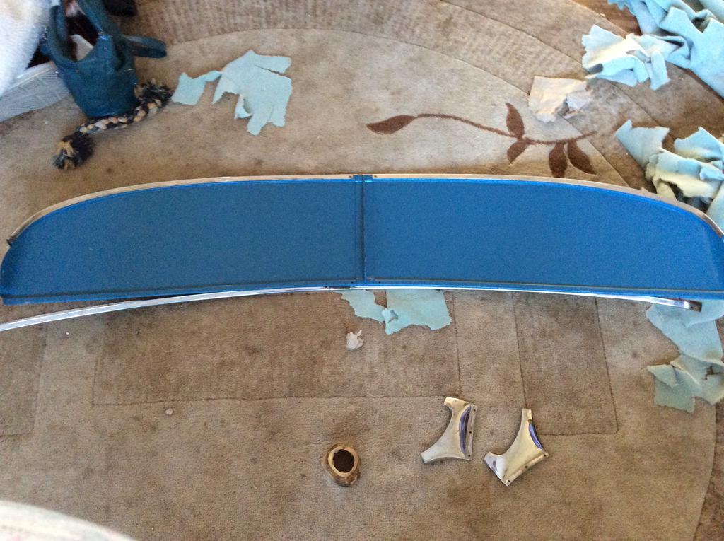

Wow, thank you so much for the information!!! I have spent a ton of time searching out information and found very little, I definitely was looking in the wrong place.
I found a Comet sunvisor on fleabay the embossing on the aluminum is kind of interesting, reminds me of the old aluminum portable/camping ice chests.
I currently have my 54 GMC/COE torn apart. I was a concrete truck driver/teamster for 20yrs, I quit and went back to school. I am a network engineer now for almost 17yrs so please keep my name and email address z32tt90ATyahoo.com and give me a shout if you have any network/computing issues, I would be glad to help you both. Ken

Yea that cheapo Comet visor would not do your COE any justice.
Hell... there is even a guy giving one away for free over here....
