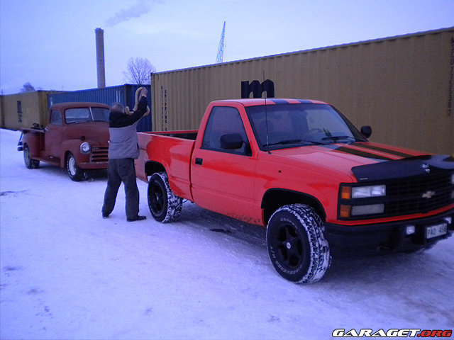

The car arriving in Florida from NC. Soon going to the docks/shipping.
Picking it up from a loooong trip. North Carolina to Florida, over the sea to Gothenburg in Sweden and then to Karlstad where I live. Cool

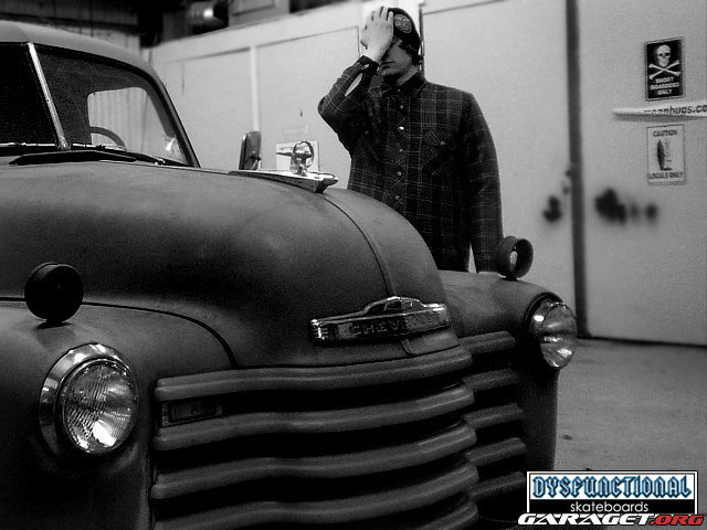

Me and the truck,,,
Finally some time for the Chevy to get some love after a hard life on a farm in N.C.
