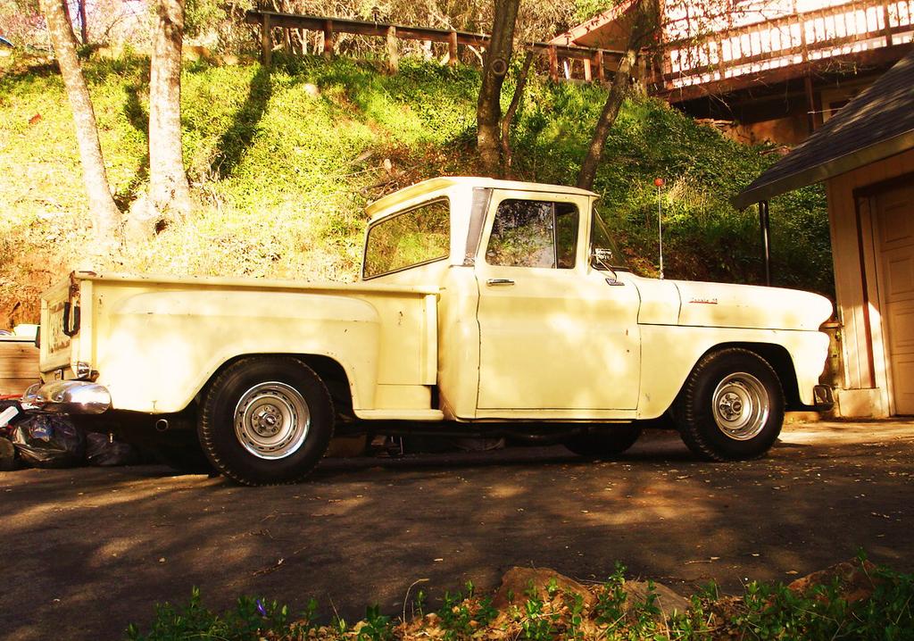

Don't cut anymore than 1 and 1/2 coils off the front and on the rear you can put jack stands under the rear frame leaving the desired gap between the frame and the stands then heat the lower coil next to the trailing arm and allow the truck to settle down on the stands. after it cools you can remove the stands and you're done....Big Tim Click image for larger version
