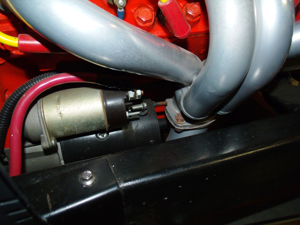

    Steve, Here are some photos I took of my two old Fords to show starter / header clearances;
    Here's the Chevy Orange 350 SBC in my Model A. It has a stock GM starter and cheap $50 block huggers.
    Here's the 1927 Ford Engine Green 1985 5.0 HO SBF in my Model T. It has a mini starter and I cut the flange off the Sanderson Headers and tig welded tubing to make a collector pipe that re-routed the exhaust away from the header.... and wrapped the collector pipe with heat tape near the starter.
    Cutting and relocating the flange gives optimal clearance. Is it needed? I'd say no. I've never had any issues with the chevy starter in my Model A... and it's as tight as the set-up you have.
    But the modified set-up looks much better IMO.
    Hope you find this helpful.

    That is clean looking work, John.

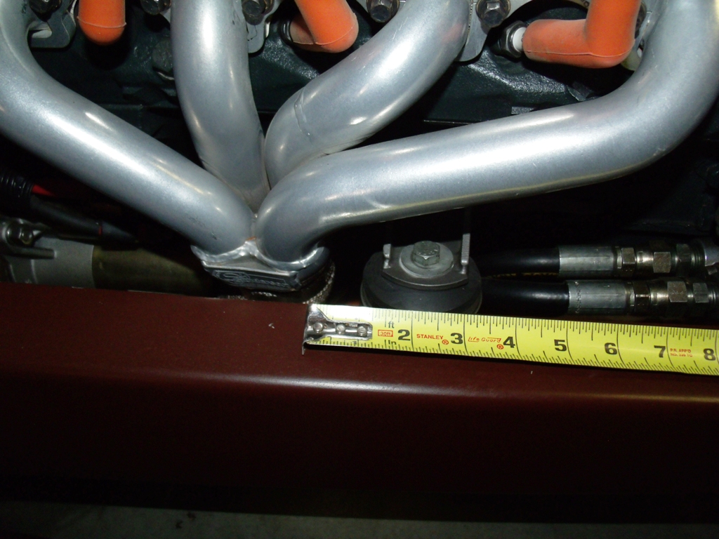

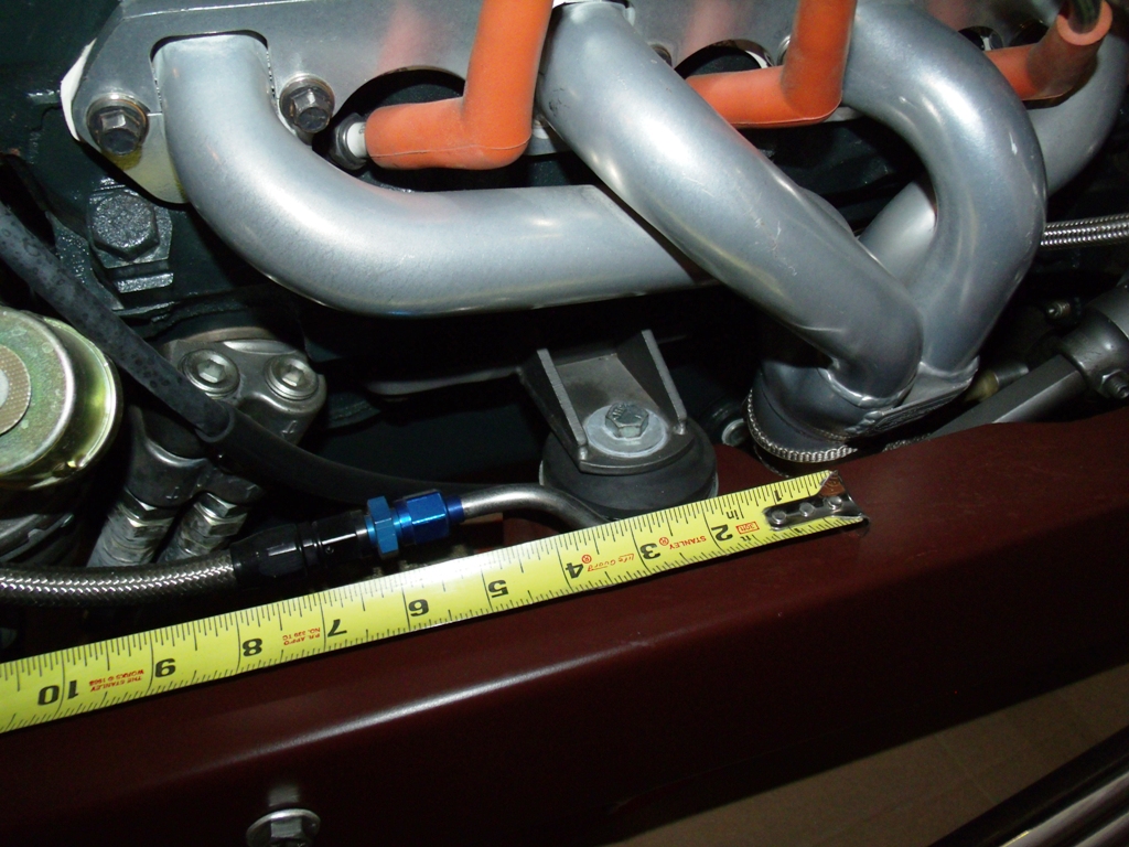

    Those block huggers of mine dump out a little to the rear of center. The left one will fit on the right side, and dump slightly forward of center.
    This puts the collector somewhat close to my biscuit style mounts.
    I notice your Ford motor has those kind of mounts. How close is the exhaust to your rubber mounts?
    Steve.
  16. Lakeroadster
    Lakeroadster Member
    Jan 23, 2011
    1,599
    Central Colorado
    Thanks Steve.
    Header to motor mount clearance is less than an inch on the right side, about an inch on the left. No hood on my old Fords means it's all hangin' out in the wind though :cool:

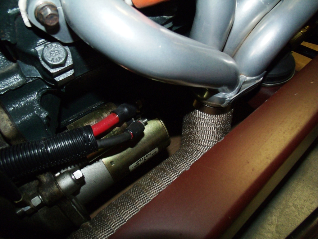

  18. Lakeroadster
    Lakeroadster Member
    Jan 23, 2011
    1,599
    Central Colorado
    A couple more photo's...
    _________
    John :cool:

    Well, now, you've really set the hook. That looks real good. Not only that, but, adding 12-14 inches of three inch pipe, before the collector, should give a noticeable performance gain. Add to that, wrapping the header tape to keep exhaust temps up, should increase perf. also.
    I think you improved the design, considerably.
    I could weld in my oxy. sensor bungs mid-way down the long, straight section, for an excellent reading.
