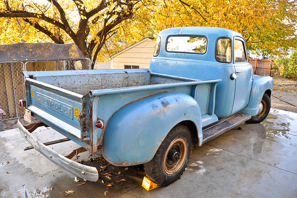

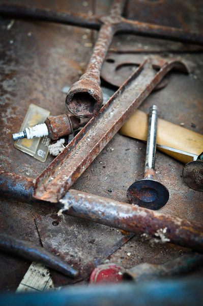

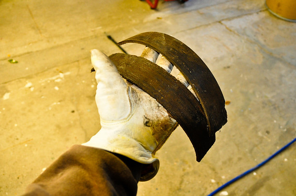

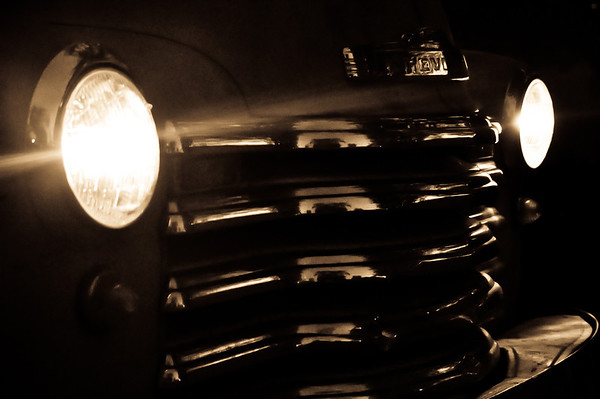

    So we had issues pretty much as soon as the truck came off the trailer. The passenger side rear tire was not turning. A little investigation found the brake show material had fallen off the shoe.
    After we got it rolled into place we pulled the plugs and turne the motor over by hand. Everything seemed fine. I was scared the motor would be stuc from years of sitting idle. The battery was shot, so I hooked up new battery and we attempted to spin the motor over. Despite our attemps we could not to get the motor to spin over with the starter. The starter was suspect and would need to come off.
    The headlights did work though!!

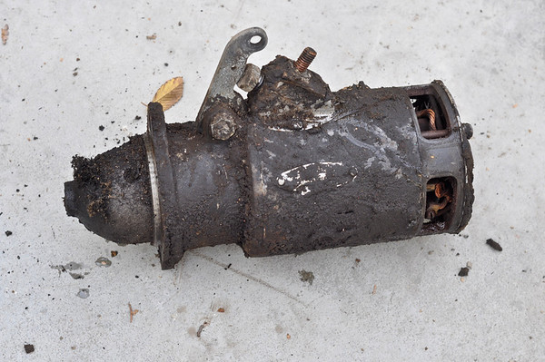

    The starter was pulled, cleaned up and benched tested. Despite it's age, it tested fine on the bench and cleaned up fine.

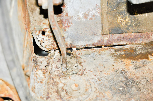

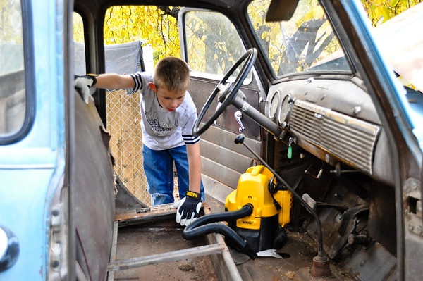

    With the help of my 8 year old son Ryder, we started cleaning up the interior to see what we were up against. Mouse poop and rust......always abundant in old iron!!
    The worst of the cancer is on the floor of the drivers side!!

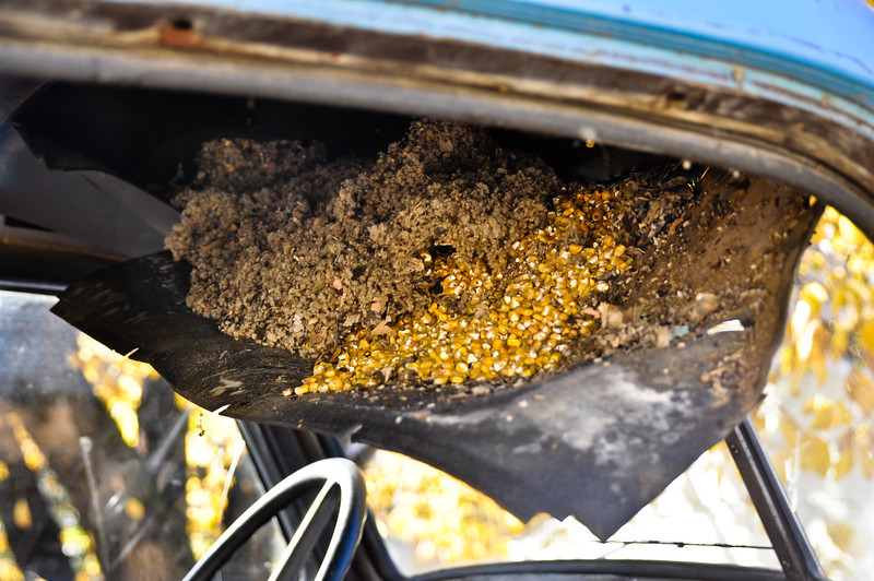

    Some place there is a really upset mouse. A 2-1/2 gallon bucket of corn above the headliner.....

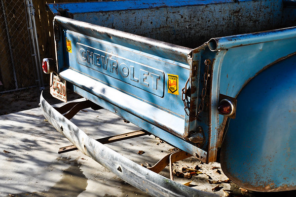

    I had a open Saturday, but I had to watch my son and a friend of his. Instead of trying to watch them and making numeous trips to the parts store trying to get this thing to run I chose to spend the day working on the exterior of the truck.
    I had read a couple articles on surface rust removal using CLR and either scotchbrite or steel wool. I decided to give it a try. I started with the hood.
    Unreal difference.......I proceeded to scuff the whole truck with the CLR and the green scotchbrite pads. Surface rust disapeared, and a nice satin finish remained.
    After I scuffed the whole truck I washed it twice with simple green and water and a stiff brush, thoroughly rinsing!!
    After that the whole truck recieved a healthy coat of Carnuba Wax.

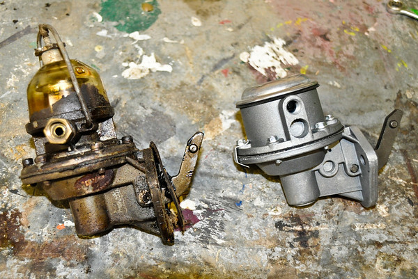

    Runs fairly strong and on all 6 cylinders but only when I feed it fuel. The fuel pump seems to not be working.
    I do not know the condition of the inside of the fuel tank so I took the fitting apart below the tank and added a piece of fuel line into a gas can. I assumed the pump would pull from their.
    I order a new fuel pump and a water pump as it is worn out an leaking horrible.

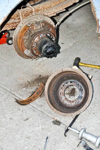

    I am now in a dilema. My brakes do not work at all......no lever feel at all. My eventual plan (likely over the winter or early spring) is to put a new rear end and 1/2 ton front axle under this truck with updated brakes. That being said, I would like to get the brakes working at least enough to move this around easier and safer in my yard, loading it on a trailer, ect.
    Any advice?

    Short of re-building your entire hydraulic brake system you might find some shoes for the rear and use the parking brake.

    I did the entire fuel system, tank, lines, pump, rebuilt the carb. Next I did all the brakes, everything. Lines, just to be safe, wheel cylinders, drums, shoes, MC, everything. I had a friend in high school get in a fatal wreck due to brakes failing. There have also been guys on this site clean a brake line, and see pin hole leaks. Anyway off soap box...
    But as Larry said since you are going to replace the rear end, then you may just want to rig it up to use the parking brake. Oh DONT throw away your old shoes, as they are NOT available and you have to get them relined, with new pad material.
    But you may find that it is fairly cheap to go ahead and rework the factory brakes, that way you can drive it and take your time finding the proper rear running gear. Just a thought. As this is what I did and have been enjoying my truck now for years. I drive it 3-7 times a week. I live 1.5 miles from work,so its great.

    Tonight I installed a new fuel pump I purchased from the local Napa.
    After I got it mounted up I blew compressed air through the fuel lines to verify they were clear. I then rigged up my temp fuel source and verified I had fuel at the pump. I buttoned up all the lines and turned it over until it started. Fired up relatively easy and idled for about a minute then died. It did this repeatedly.
    I am not too concerned, I did not open up the carb at all, nor did I look at the points, plug, plug wires or the coil. All those issues will be addressed shortly.
