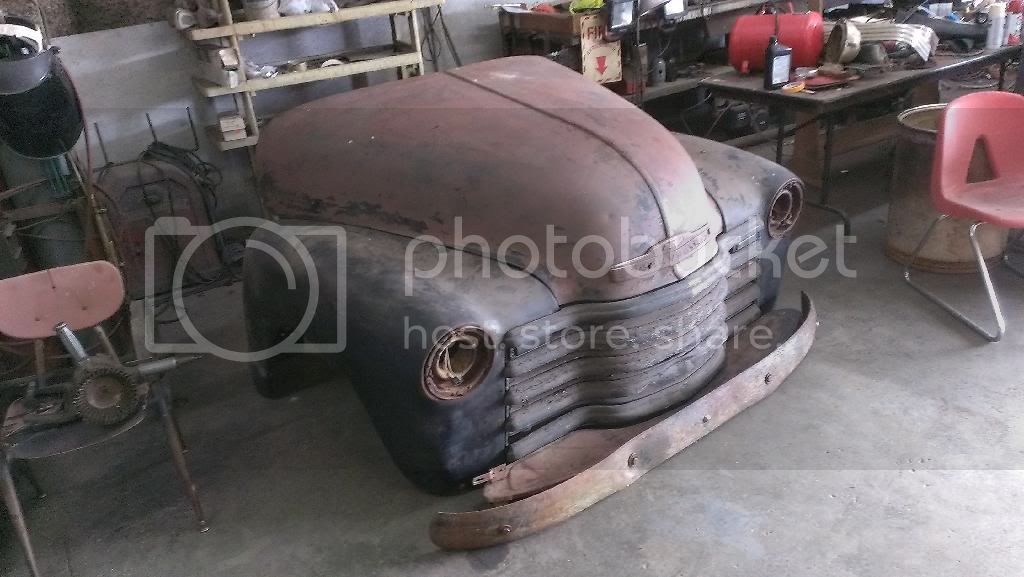

    I recently traded around and ended up with this "gem". It's my first classic truck build. I'm used to laying s10s and silverados on the asphalt. I've already started taking it apart cutting out rusty panels. I feel I may be slightly in over my head on this thing but I've told myself I'm doing all the work. any advice or tips on these trucks would be awesome and I would appreciate it. my plans so far are either s10 frame or Camaro/nova front clip with 2x4 tube rear clip and four link, the 228 inline is gonna go because it is not running and for what I would spend to make it run and be road reliable I could get a small block and a th350 or 400 and be on the road (this thing will be driven, that's why we build em right?) I have some air ride components left over from other projects but I'm not sure if I will use them or just do a static drop. I know I will need the outer cowl panels, front floors, toe panels, inner kick panels, and the inner cowl pieces. that list will probably grow the further I take it apart. the truck does not have abed so I'll either have to find one or get creative with a nice flat or tow truck type bed. here's a link to the photobucket album with my progress so far. http://s1189.photobucket.com/user/Dweb7321/library/krusty?sort=3&page=1 thanks for looking guys

    so I have my right kick panel and outer cowl roughed in, I tried test fitting the inner cowl filler, not a good fit at all. any companies make a better one or should I try to modify the ones I got to fit

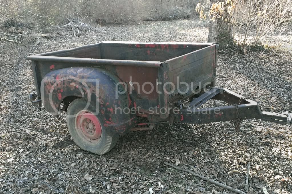

    also I've rounded up a bed and doghouse. got both for $300. bed is first series 55 and doghouse is 51-53? chevy. I also got some full length running boards. just need a frame now, considering shortening the 3/4 ton but not sure yet
