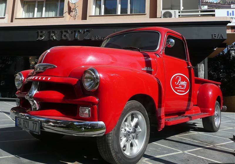

    Hello to everyone...
    I have 1954 Chevy 3600 3/4 ton truck. I need ring & pinion kit for my differential. It is factory parts. My factory engine changed. It is 265 cu inch V8 engine now. Transmission is manuel column 3 speed but I will do automatic on column. Truck is very slow. I want to buy new ring & pinion kit.I want to destroy the sound on differential.
    What is my truck factory ratio?
    What is your suggestion ring & pinion for 265 cu v8 engine?
    Thanks.Serkan
