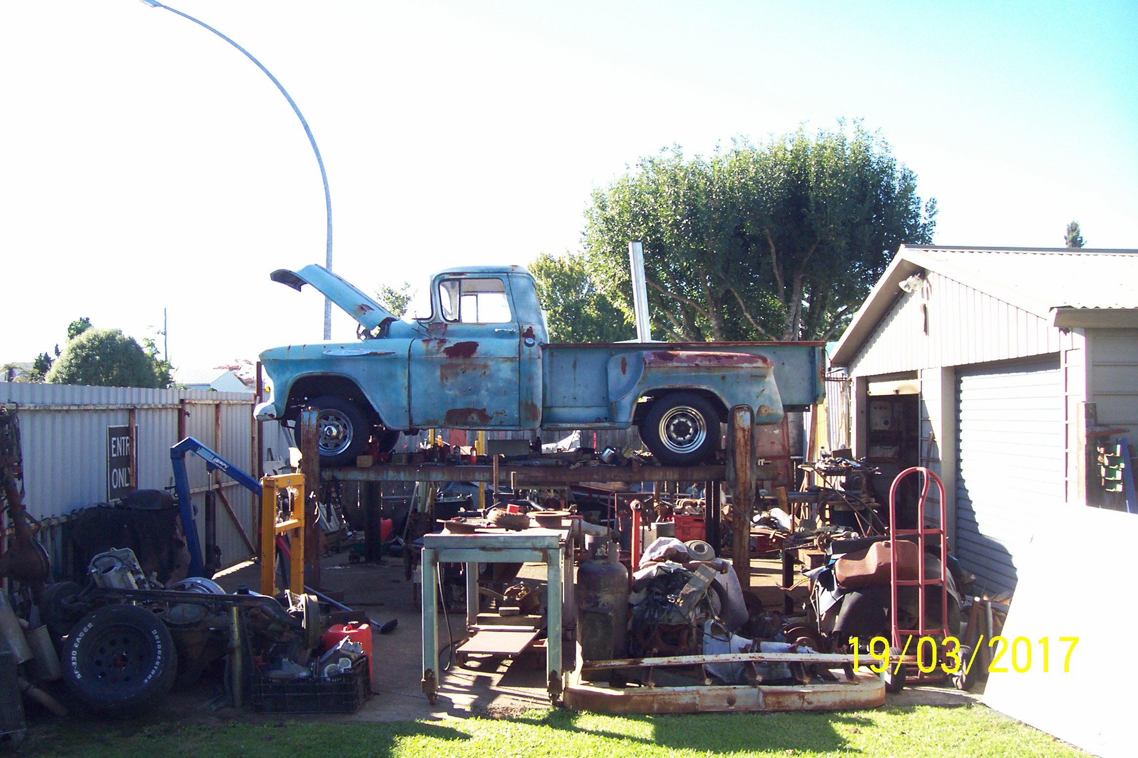

    hey all ,, doing my 3600 and want to change to 5 lug wheels ,, at present it has 8 lug ,, does anyone know if the hubs on a 3100 and 3600 swap ??? im thinking the stub will be bigger on the 3600 ?? have access to a 3100 axle and hubs if I want ?? im mainly changing so i can put discs on front axle ......
