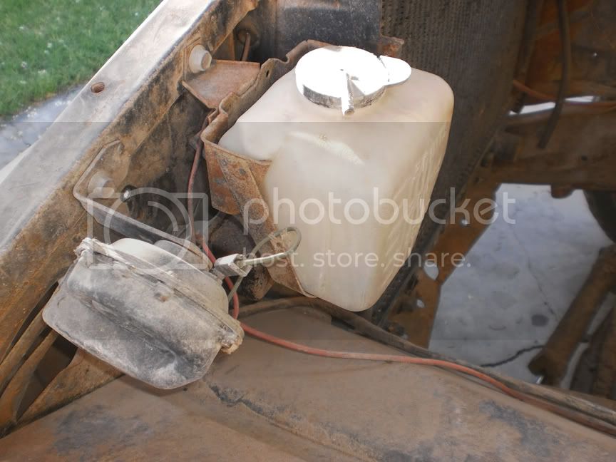

One quick question guys, where would the original position of the washer bottle be in the engine bay, as i want to keep things as original as possible?
Thanks again for your help:)
If it had power brakes it was mounted next to the rad as shown here, if non power brakes was ordered it resided inbetween the master cylinder/left inner fender
