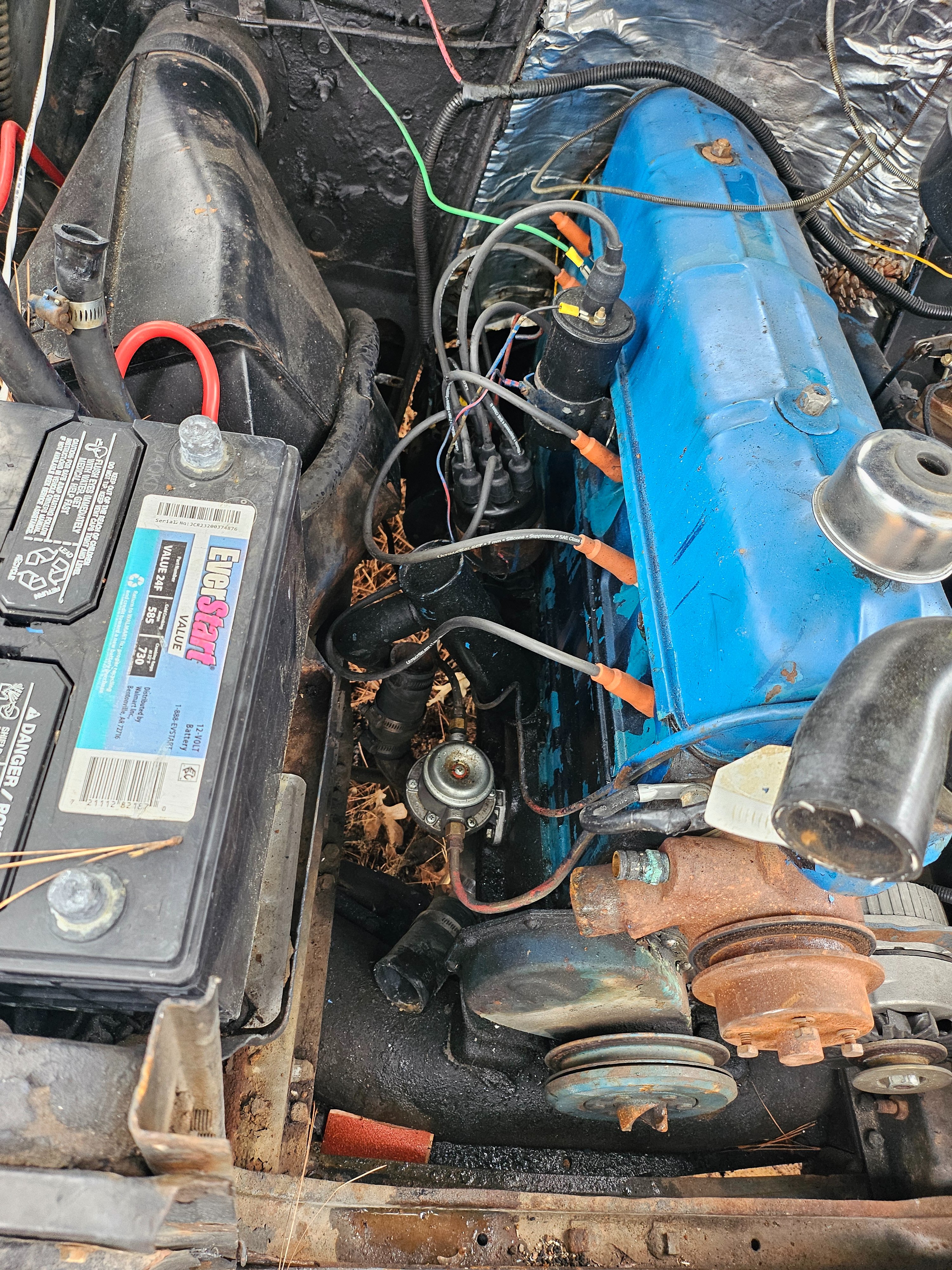

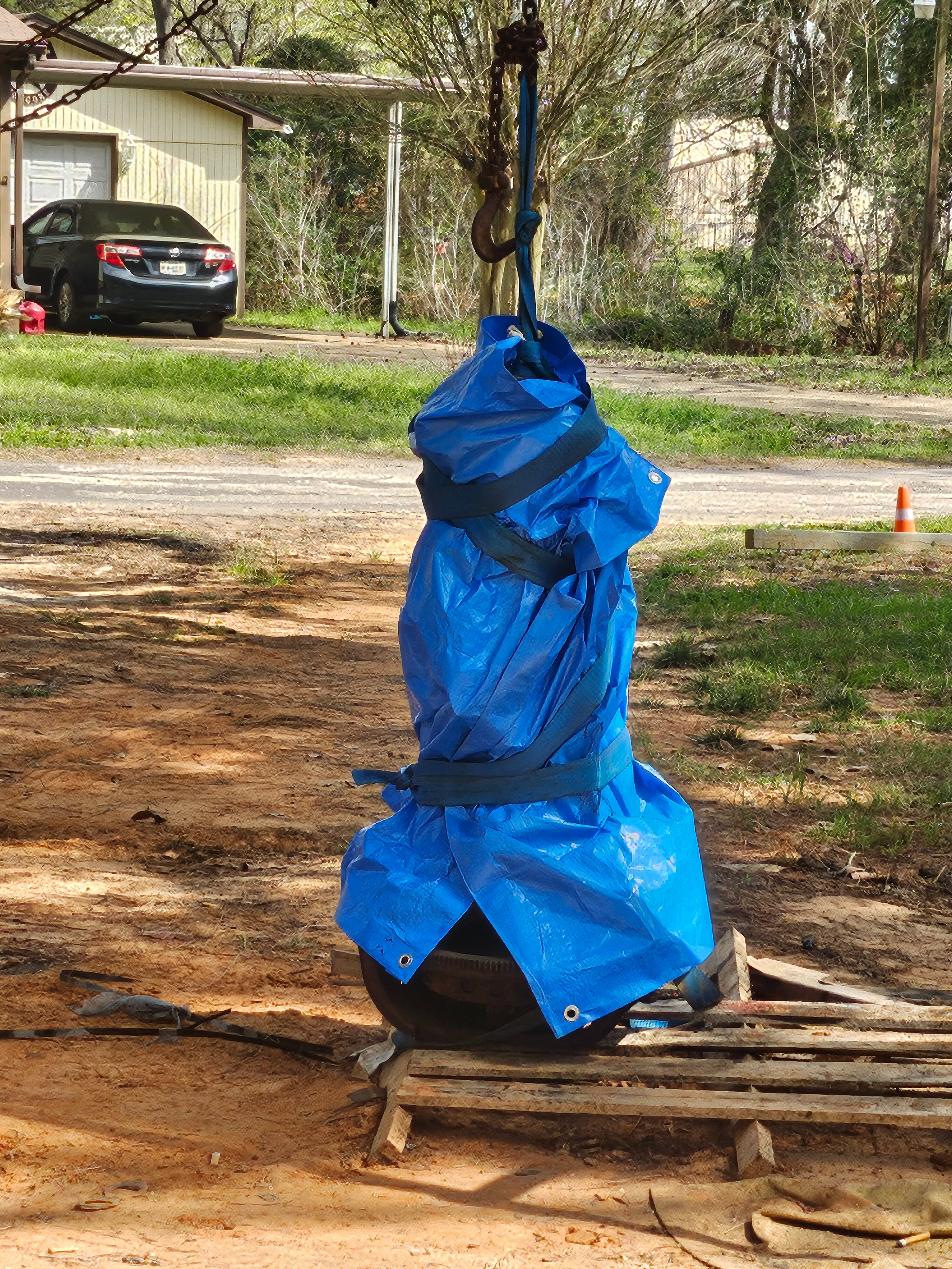

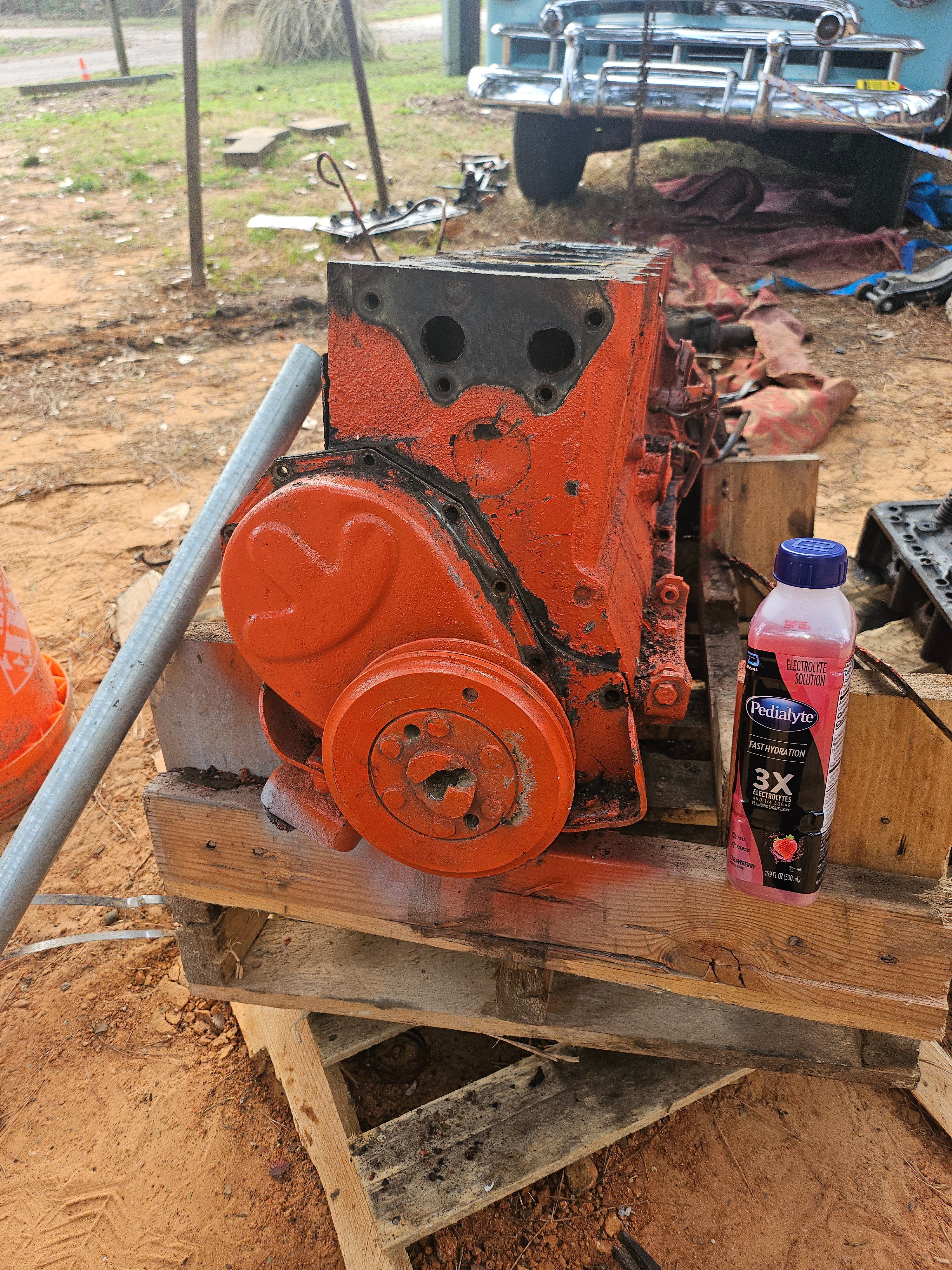

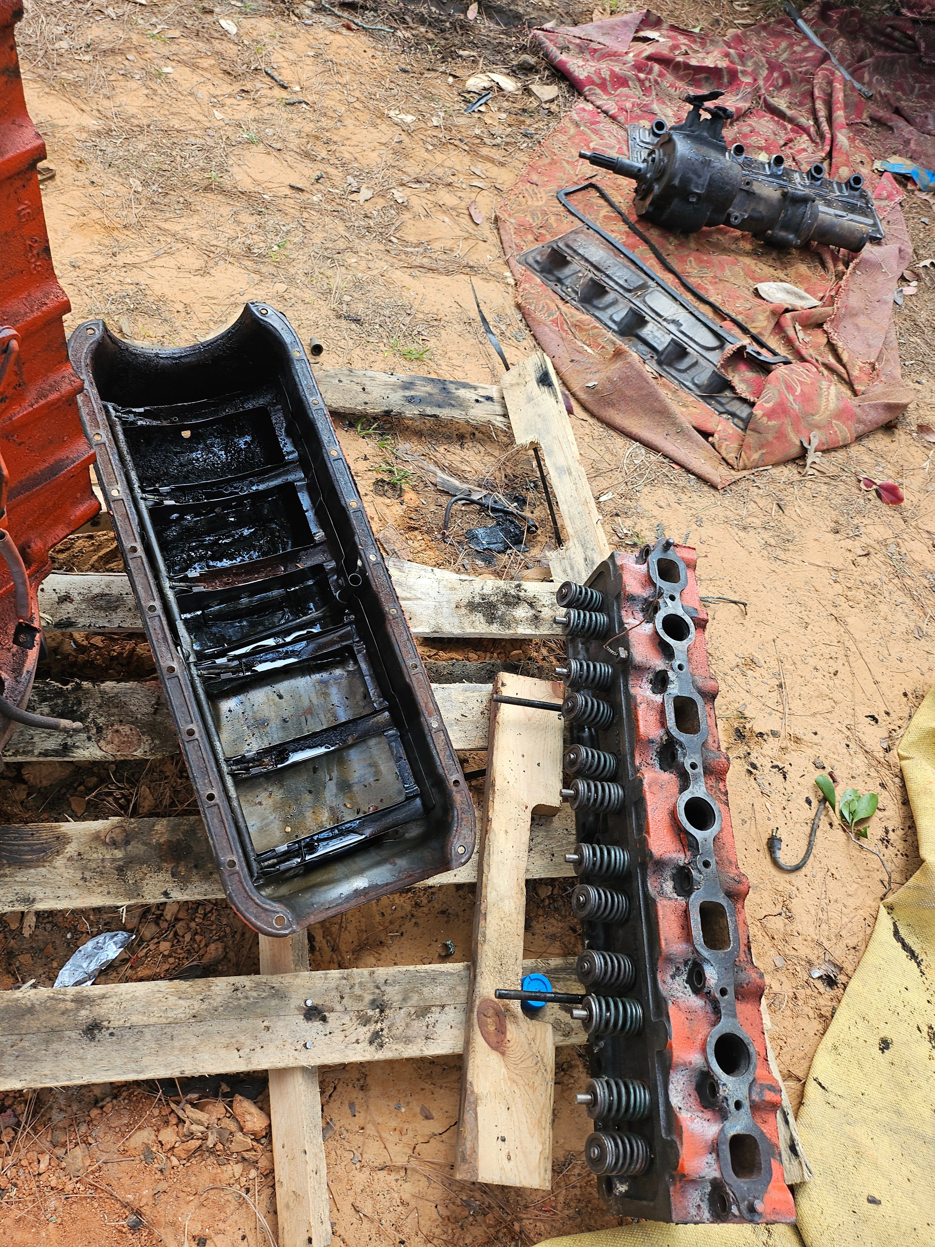

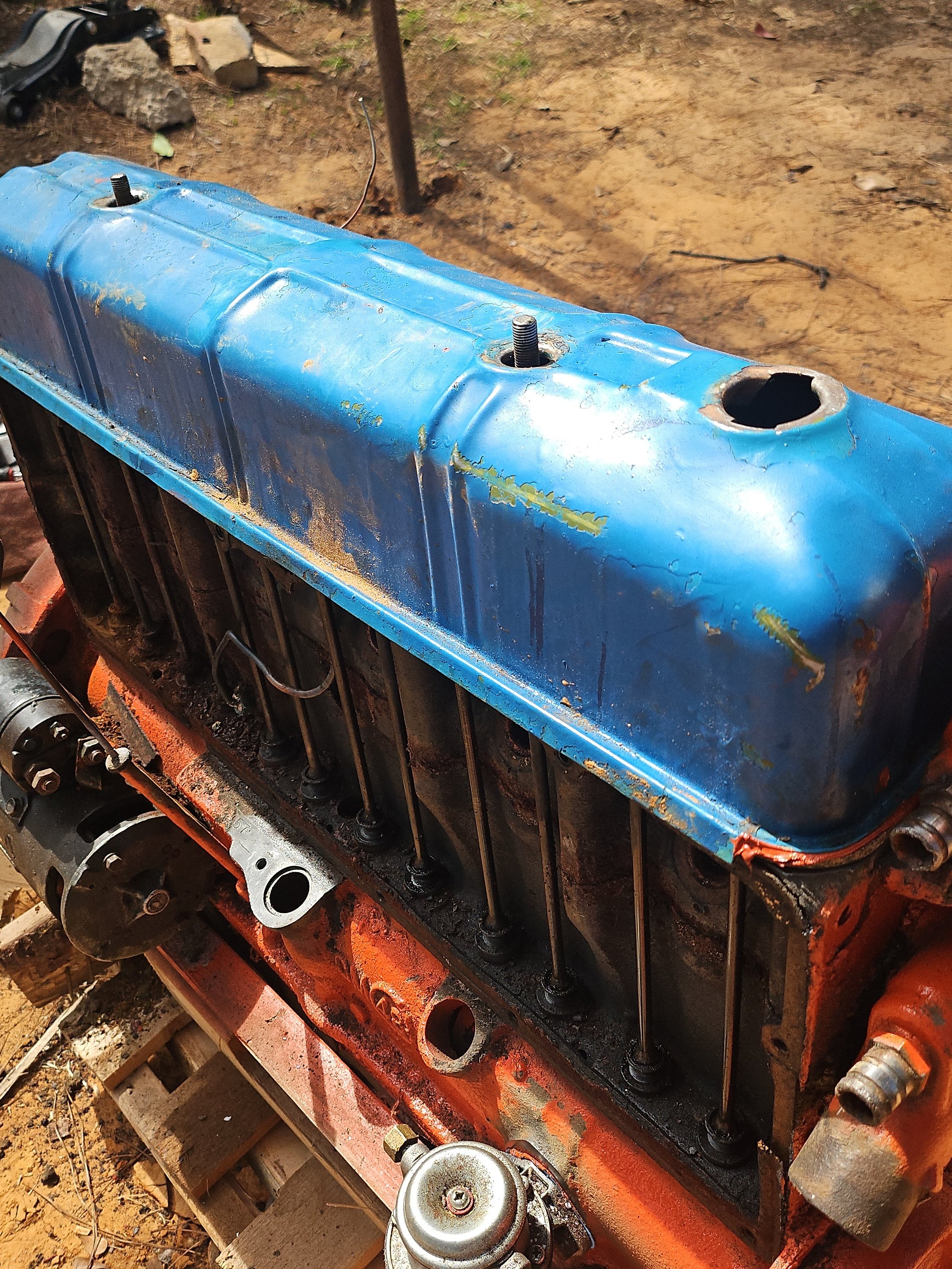

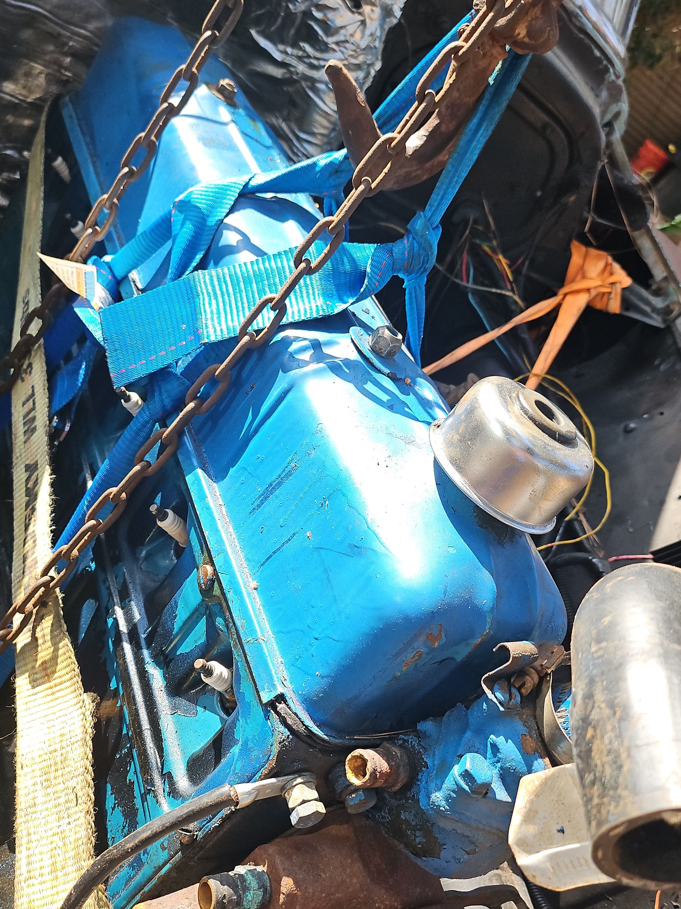

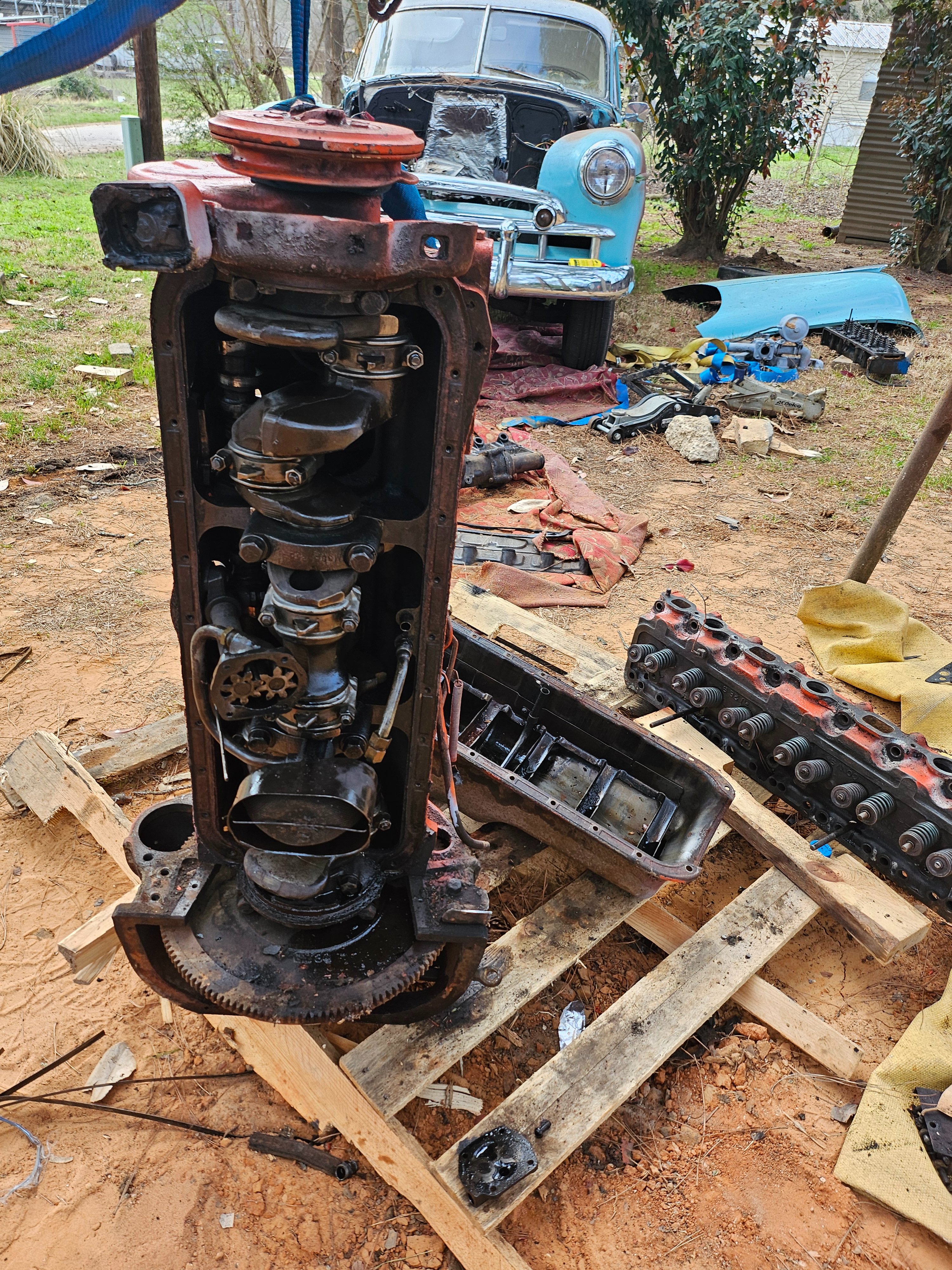

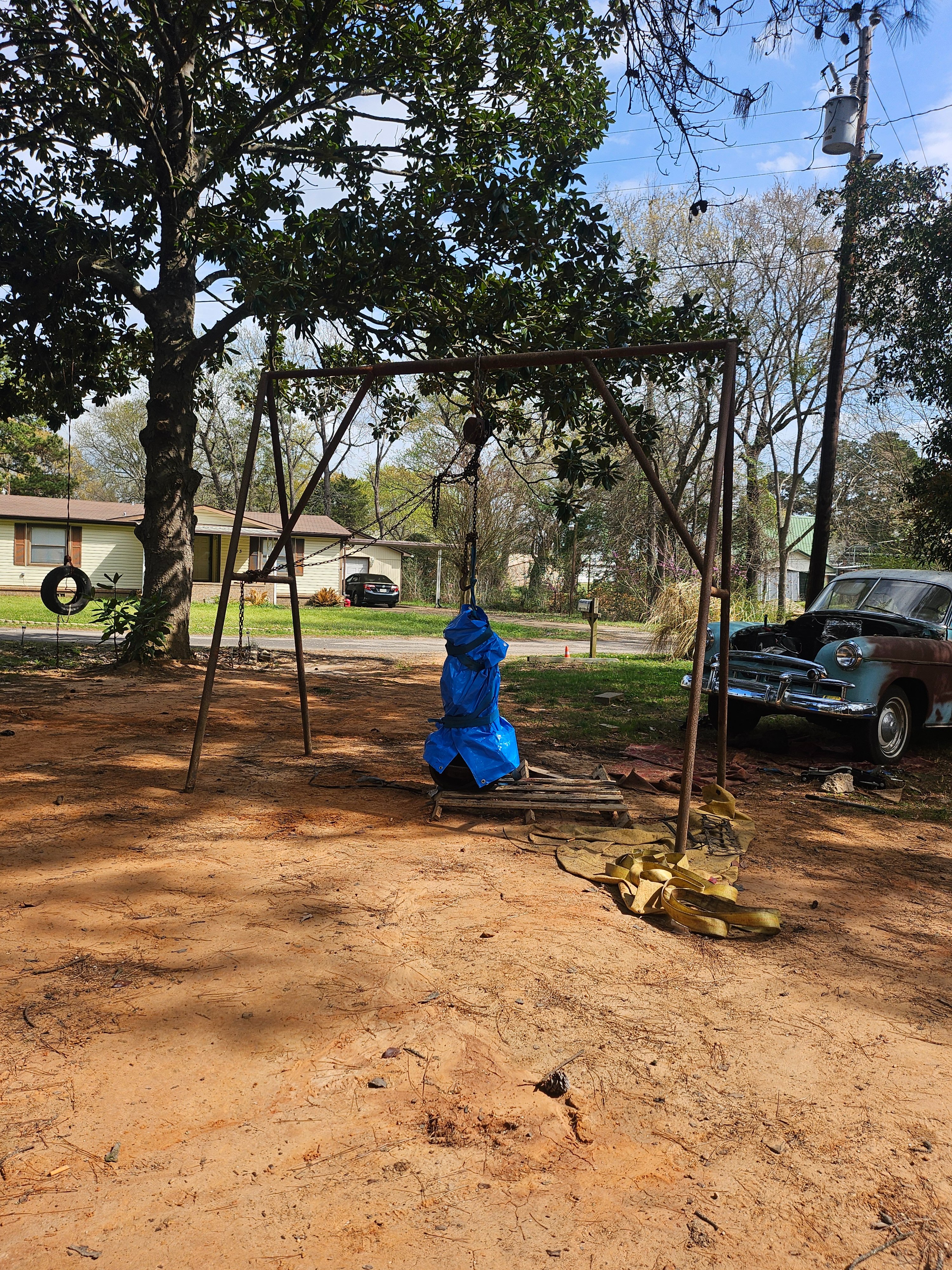

I have a 1948 Chevrolet Styleline Deluxe with a 216 engine and I'm looking for another engine. I had bought a 216 core but it was really bad so I'm needing another engine. Staying with my 216 engine having a hard time taking out the lifter's. Ugh I'm new at this and this is my first old vehicle and I plan own keeping it and I have 2 216 engine cores now OMG 😝 🤣 😳

That one doesn't look as sludgy and all the ones I remember from the 60's & 70's .
If it's original the pistons will be cast iron (!) and never wear out .
I concur, a 235 / 261 is a sturdier and more powerful engine, not prone to throwing rods like the earlier " Target Lubrication" 216's & 235's were . (" whaddya mean don't drive it 60 MPH ?! it'll go 70 with only 1/2 throttle" .
