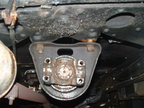

    The 3/4 ton GMC (and Chevy) trucks of the 48-53 era are unique when it comes to driveshafts. They have an enclosed front U joint and driveshaft like the smaller 1/2 ton trucks do, but about 3 feet to the rear the enclosed shaft ends at a hanger with an exposed mid point U joint. On the rear side of the mid point U joint is a splined slip joint that attached to an exposed rear driveshaft, through another exposed U joint that attaches to the pinion shaft on the rear end.

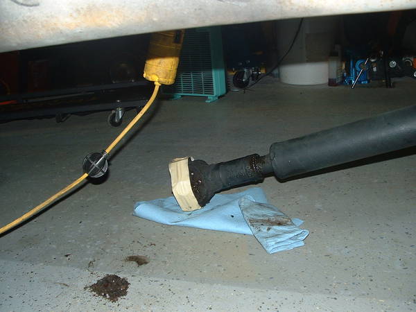

    We started by removing the rear driveshaft from the front driveshaft by taking the U bolts from the middle U joint. Per the manual we taped up the U-joint caps to keep from losing the needle bearings.

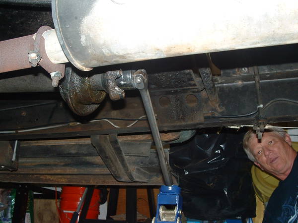

    The manual called for totally removing the front shaft before disassembling the components of the shaft. The big nut (1 1/2" socket that neither Bill or Bill had)
    looked to be impossible to break loose once the shaft was removed from the truck because we didn't have any way to hold it given that the torque value for the nut was 160-220 foot pounds. Bill headed to FLAPS and came back with a 1/2" drive 1 1/2" socket. I crawled under (3/4 ton truck with 31" tires has enough room for even my 295 pound body without raising the truck),
    pulled the cotter pin and tried to loosen the nut. No luck. Engine turned. We removed the flywheel cover and Bill stuck a pry bar in into the flywheel teeth to prevent the engine from turning.
    I got on the 1/2" drive 18" breaker bar/1 1/2" socket combination and gave it my all. No move. Scratched my head for a while and the Bill came up with a brilliant idea.

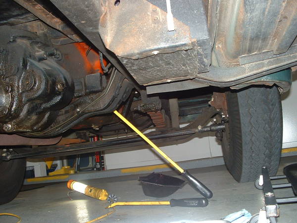

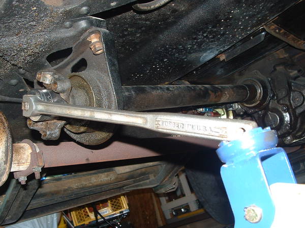

    Bill rolled a floor jack under the truck and positioned the lifting point on the jack under the end of the handle of the breaker bar.
    I went back to the flywheel to make sure the pry bar stayed in place. Bill started raising the jack. After a few false starts and Bill commenting how far the breaker bar was bowed, there was a loud pop and the nut came loose. Once we took a look at the piece of the breaker bar that the socket mounts on we found that it had twisted about 10 degrees. No telling how much torque it took to break the nut loose, but it was WAY north of the 160 pound minimum. No way we could have broken the nut loose on the bench per maintenance manual instructions.

    By the way Bill, we guessed right about the orientation of the hangar. We could have verified it if my old semi-busted camera would "play back" pictures.
