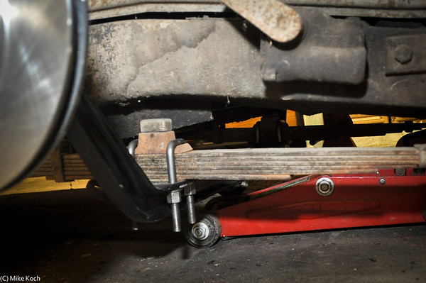

    Leaf Springs
    Eaton or Diamond ~ $aving one Dollar on springs will bite you in the butt worse than you can possibly imagine because it'll make your truck unpleasant to drive or ride in .
