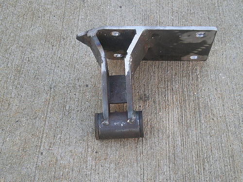

    What I used
    I did install a 350, SB and used the mounts pictures no issues yet. I like the fact no cross member clearance issues with the oil pan or anything. I also like my header slection too. But that's just me.

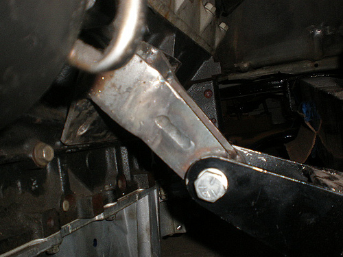

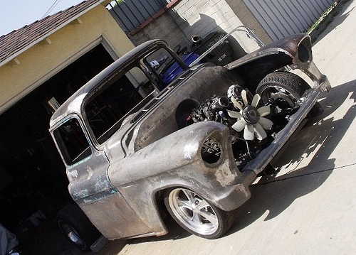

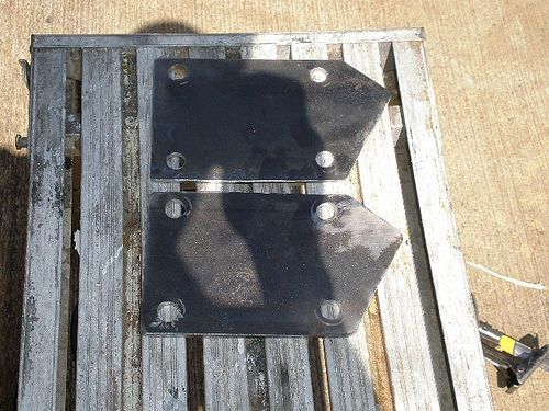

    I'm doing a 5.3 4L60E install on my truck. I fab my own motor mounts. But you can use the kits and they will work fine. They had adapter plates that allow you to use standard small block chevy mounts.
    Here is what I did.

    nice work
    well the v8 crossmember i ended up taking about and inch and a hald out of the center and rewelded it together, and it works great. I have the engine in and the transmission cross member in but not bolted down yet. Also, i picked up an S10 rearend with disc brakes and im putting that in this weekend heres a picture of the progress on the front.

    coilover Member
    Mar 30, 2005
    2,564
    Plano US
