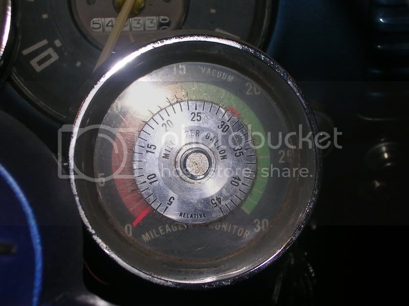

  6. ol' chebby
    3,164
    Here is mine.
  7. vwnate1
    11,677
    Sweet !
    That's a really nice one ! .
    Big too , most are standard 2" .
