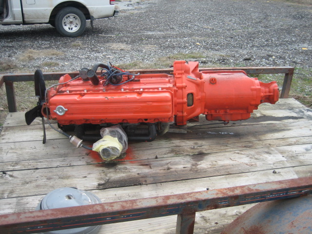

    Lots of machining to convert a torque tube trans to accept an open drive shaft. Would be easier to put the entire 54 tube set up onto the 55.1 but it would not be a bolt in. If the spring length and front I-bolt and rear shackle brackets are at the same spot on both frames it would ease the install a bunch. The 55.1 springs have the spring center bolt center 1.5" forward of the 54 since the torque tube spring mounts are the "rocker type". All in all a real can of worms that is exactly backward of the normal tube to open shaft install. A huge step backward in available gearing by using the torque tube. IIRC the auto rear gear was more cruise friendly than the 3.90 manual trans gear. The 54 Hydramatic starter is pure gold in ANY condition. I bid $900 on auction site on one that finally went for $1200. Here is a 54 235 and Hydramatic the Volkswagon resto shop did that set outside till it finally seized up and was sent to the scrap yard. Everything in and on the engine was brand new as was the trans. All for the lack of a starter. I offered it for free on this site but no takers.

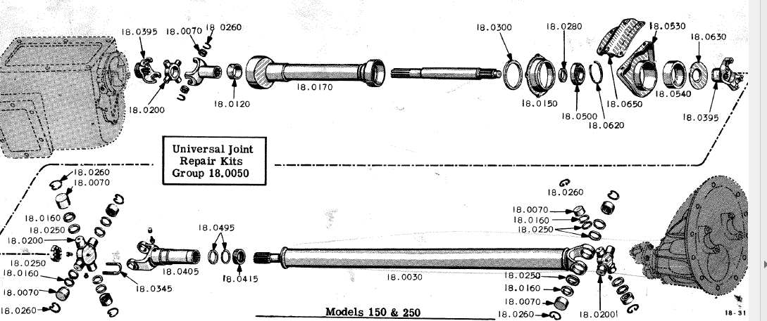

    Also/again, there’s a guy named Gene that makes these:

    3/4 ton (like my '52 GMC 152) has an enclosed driveshaft at the front that went less than half way towards the rear axle. At the half way point it has an exposed U-joint connecting to an open driveshaft that feeds another open U-joint connected to the input of the differential. Also at the half way point is a hanger attached to a frame cross member (probably have to fab that) holding up the shaft where it comes out of the enclosed tube.
