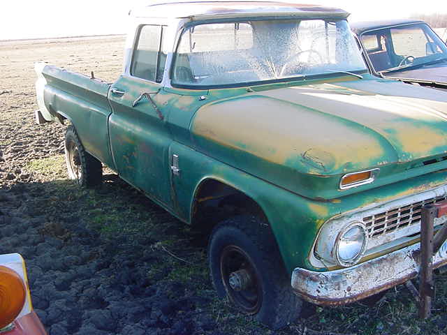

    here are some pics

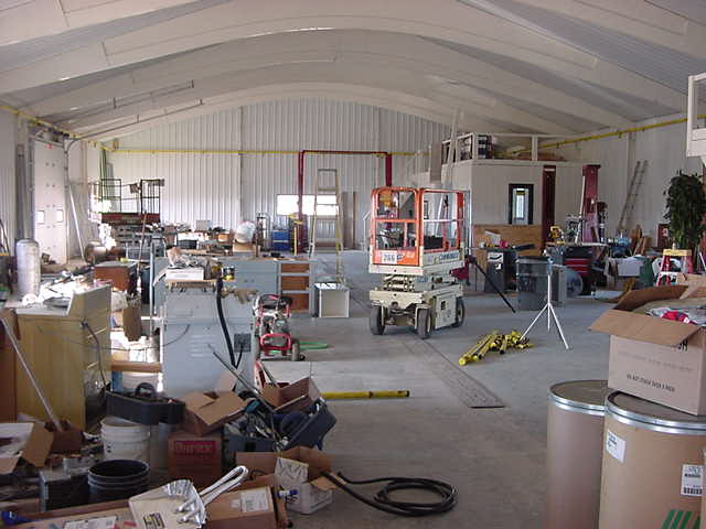

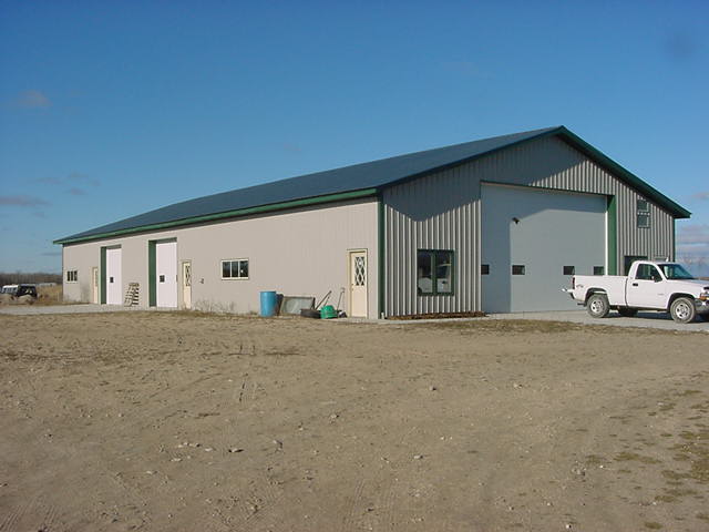

    here are a couple pics. Pics of the shop we are in the process of building. Thats where I will be tearing down the 65. It is 80x108. Has a living qrts in it also, 2 rotary car hoists, machine shop welding area. We are in the process of hanging 2"airline around the inside now. I am hoping we can get it completely wired up and working by mid winter.

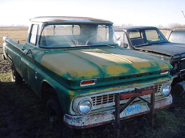

    nice snow!!! your truck looks like a 62-63 looking at the doors in picture.:confused:

    Hmmmmmmmmmmm you are right. I have always been told that is was a 1965. I guess I will get the vin# 2morrow and find out for sure what year it is. Thanks for pointing that out.:)

    By the way your truck looks good. It looks like a 63, thats definitly a 63 grille. The cab is also 60-63. Good luck!!

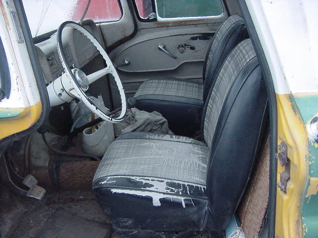

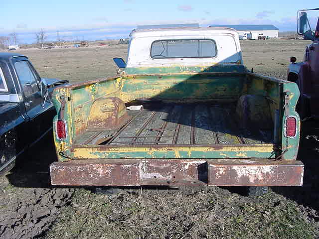

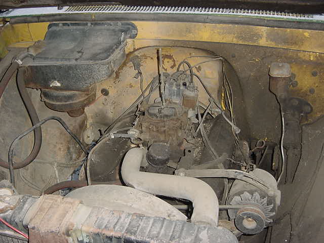

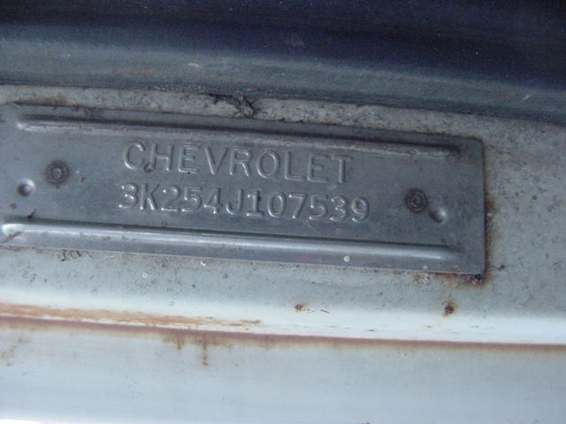

    heres a couple more pics. of the interior and engine

    Went to www.oldtrucks.com ran your VIN numbers from your photies its a
    (1963 chevy K20 4x4 3/4 ton made in Janesville,Wis. plant) check that site out its cool:cool: got interesting things on it.
