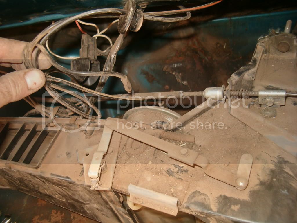

  15. tucsonjwt
    tucsonjwt Member
    Jul 16, 2010
    1
    Location of HVAC vacuum switch
    Does anyone know where this HVAC vacuum switch is located on my 83 C20?
    AC Delco p/n 15-71518?
    I have the round vacuum switch attached to the back of the HVAC control in the dash, but I can't find this one.
  16. Reinovator
    Reinovator Member
    Feb 6, 2008
    145
    Northern AZ
    hello I was looking through this and thought this shot may help, I have more of other areas. I took these to help me remember where my vac lines went.
    yea its dusty, the lay out of my 77 is very similar to my 87.
    my 77 has the same valve as the one posted, I believe it is a dealer install factory Harrison A/C system:D
