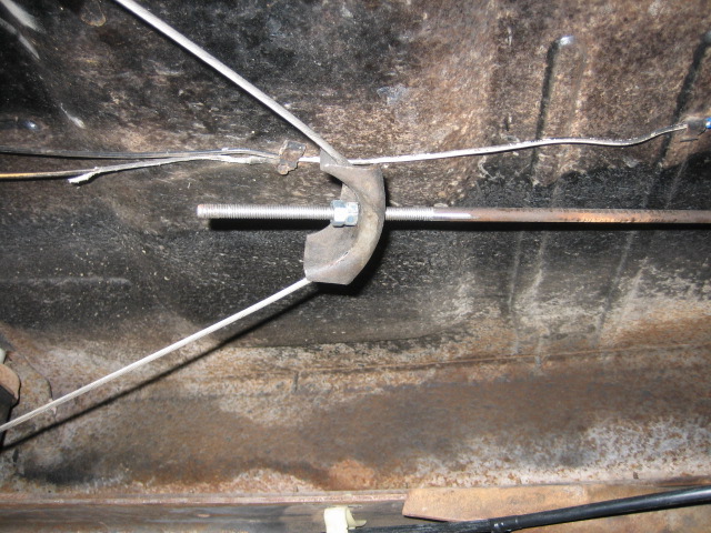

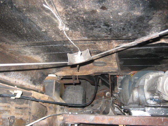

    I see posts asking about this and we use a quite simple approach that works well. The factory rod that runs from the foot pedal to the AD tubular cross shaft is cut and threaded and then an equalizer off of any open rear vehicle is installed on this threaded rod. The e-brake cables from the backing plates on the open rear end are then run through the equalizer so the splice connection of those cables is to one side and does not interfere with the cable sliding through the equalizer. Pictures will clear up a murky discription I hope. This is on an S10 conversion but by-passing the cross shaft on an AD also makes the job easier.

    You knew that question was coming, huh? I look forward to the day I am hooking up the e-brakes to my new Colorado back axle. I'm sure this would have been a question. Thanks for the pictures!
