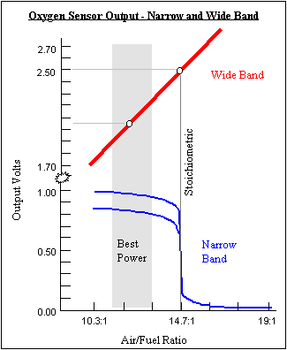

    Same threads Bill. Narrow band is just so antiquated, nobody lists it anymore. But it is the one you need for using a meter to read it. They are cheap and you can always move to a wide band later. The problem with the narrow band is that you can't get a reading at road speed (35mph up). Too much turbulence in the exhaust stream to effectively measure. It is good to about 1000 rpm or so. To measure higher speeds/loads, you would need to research the concept of a wide band with some gauge solution. I still find it very useful because if the mixture on a Rochester B is good at idle, as it graduates up the rpm scale, it will be good at speed. Its all 1 to 1. Too much fuel in at idle will be too much fuel in at speed. Not sure about the Zenith. In any case, an O2 sensor will give you more information than what you had to start with. Fun Stuff!

    Why wouldn't a wide band sensor work with a voltmeter? Does it react too fast and make meter readings useless?
    Interesting chart I ran across while web surfing:
    It explains why Deve had such a hard time adjusting to exactly .5 volts.
