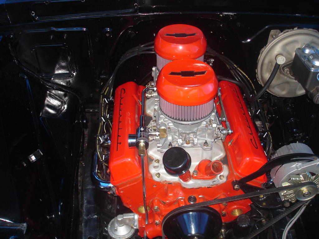

    I made these air cleaners out of the origonal hubcaps on my "61"...Big Tim :cool: 005.jpg
  10. ccharr
    Tim,
    Those are great, how did you fasten them to their bottom plate to cabby's?
  11. bigtimjamestown
    bigtimjamestown Member
    Jan 11, 2010
    683
    Jamestown Ca.
    I welded a coupler nut to the inside of the upper half then used a piece of all thread and screwed it down in to the carb. Then just spin the upper half down on to the all thread....Big Tim :cool:
  12. ccharr
    Thanks Tim,
    Those really look good sitting on top of that motor.
