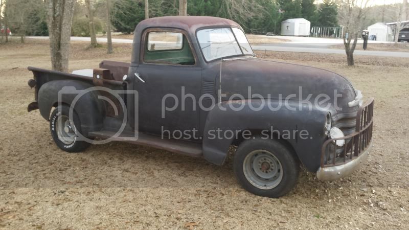

Yeah she's been off the road for 30 years and I got her running again last week. Need to finish up alittle wiring on the inside of cab and brake lights, install alternator, new wheels and tires, brakes and exhaust and she'll be road ready. The radio even has power but speaker may be blown

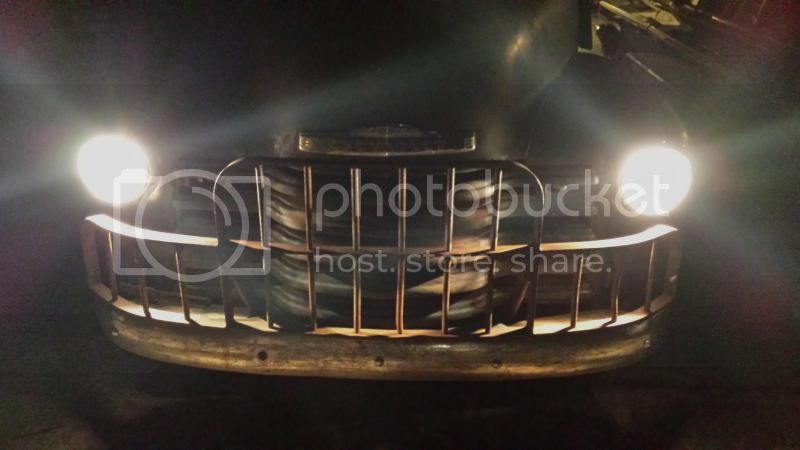

Newbie ! WELCOME PAUL ! . That's a nice looking rig you have there , I hope you keep the grille guard . DON'T put 12 volts power to that radio ! you'll destroy it .

Oh yeah the grille guard is my favorite part of the truck! I'm gonna clip that wire to the radio and maybe put a voltage reducer on it. I'm going to install a aftermarket head unit under the dash though. Thanks for the kind words and advice!
