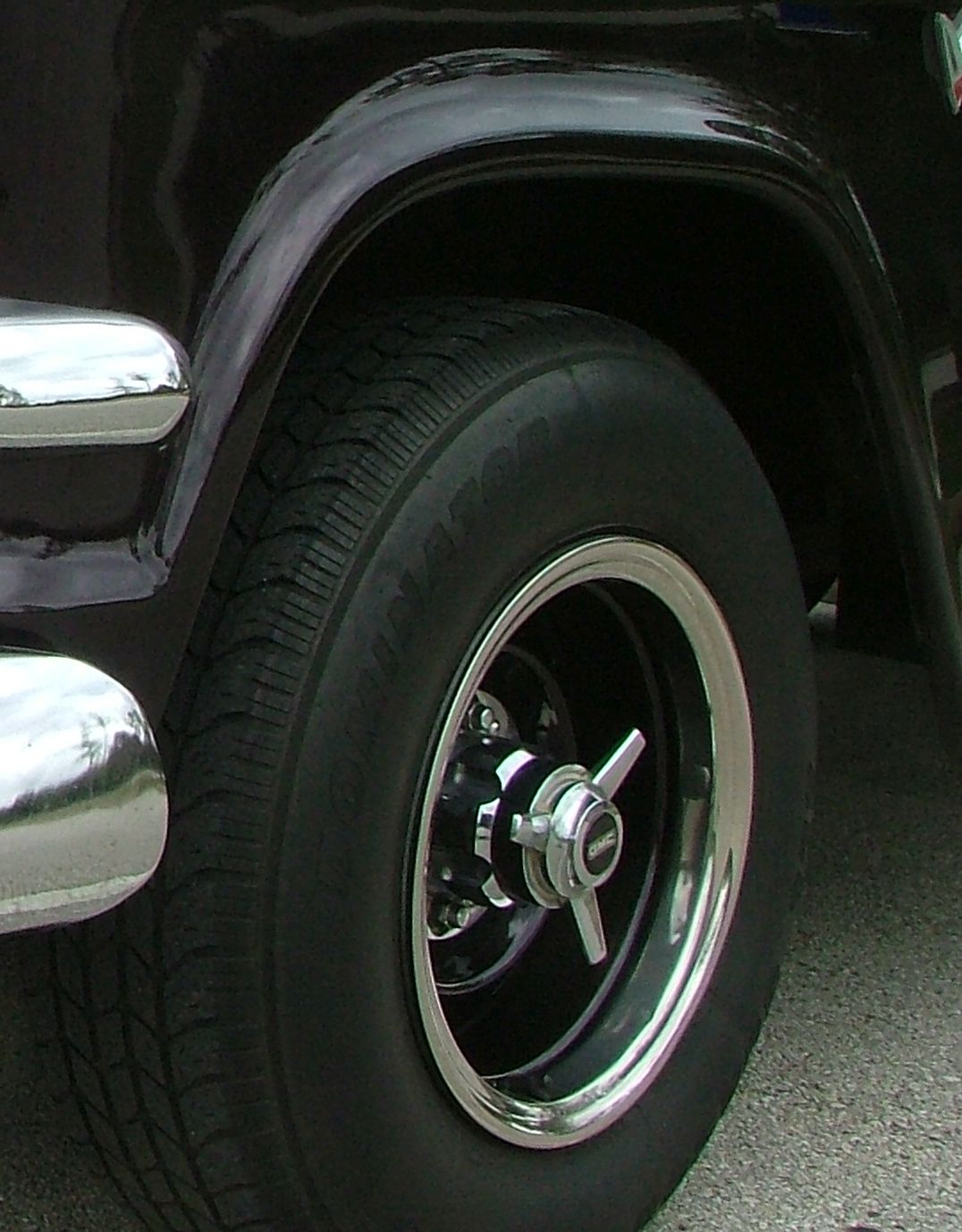

    I had 1977 Chevy 1/2 ton 4x4 wheels on my 57 GMC 1/2 ton (which uses the same hubs and brakes as your '54 Chevy. The knockoffs I found on eBay. I later added disk brakes and the wheels still cleared. I had 235/75x15 tires mounted.
