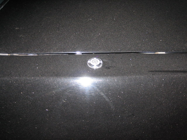

    Bill, American cars in the early to mid-seventies, especially luxury models, used power antennas where the top of the mast tube nut was almost flush with the sheet metal surface. A problem, but not unsolvable, is mounting on a sloped surface. I would use a piece of aluminum bar stock that is enough bigger in diameter than the OD of the tube so you can bore a hole that is a snug fit to the tube and also turn an 1/8" off the lower part of it so's to leave small flange on top that is thick enough to cut at the same angle as the mounting surface. The bottom of the flange will need to be cut at the correct angle. All the support mounting would need to be at the bottom and part way up the tube since the new nut is just a slip fit onto the top of the tube. You can't have it threaded because you can't continue to turn the nut once the low side contacts the sloped sheet metal. The exception is if you have room to turn the whole unit then a threaded nut could be held in place but there's usually not this much room. Here's a shot of one these "flush mount antennas" on a 73 T-Bird.
