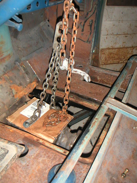

    Ahhhh, come on it ain't THAT bad. The job itself is relatively easy and fairly straightforward. You never did a clutch job ever before??? Just make sure you have a boom style engine hoist to lift it and have guide pins (bolts with heads cut off) when re-installing it. See attached thumbnail of when I installed mine the right way (with broken and smashed finger). Note space-age flexible corrugated fiber transmission cover used to keep falling debris out of tranny after the top is taken off. Now that my tranny is installed, I can let you have the aforementioned space-age flexible corrugated fiber transmission cover at a special "friend of the forum" price. Just ask and I'll pm you with the details.;)

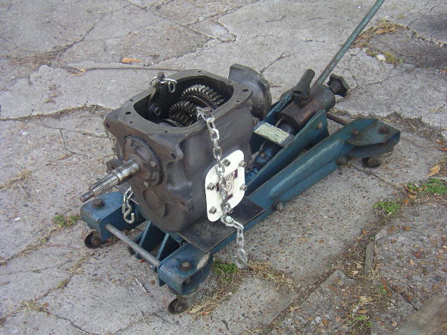

    i borrowed a big tranny jack from a friend and went in from the bottom. Notice the sm420 is secured with chains. The rounded case is not conducive to being stable.
    It worked. I also have an ole tranny pilot shaft I use to keep everything in the clutch assembly in place until ready to slip the tranny in place.

    Boom hoist goes in through the open door and LOWERS tranny to the floor. Tranny does not come out through engine compartment. floor access hole is just that...a floor ACCESS hole. allows you to use the hoist CAREFULLY so as not to scratch up your expensive restoration. Remove seat and seat frame and there is plenty of room to lower the tranny safely with the engine hoist. Note how the tranny is chained and bolted to the plate on the floor jack in another post. The rounded bottom of the Muncie would still allow it to move even with that precaution. Really, the hoist worked just great and I installed it by myself and essentially one-handed due to my right hand being bandanged at the time.
