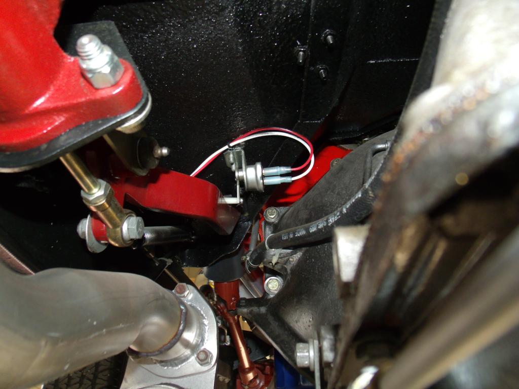

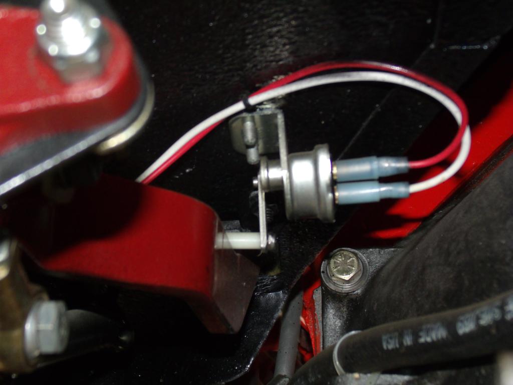

    If neither has the switch built into it then you can by a switch and attach it to the shifter arm on the transmission.
    I used the mechanical switch shown below for brake lights on my Model A Hotrod. will work equally well as a backup light switch. It has an adjustable arm and it's worked trouble free for about 15 years.
    Here's a couple links:
    Adjustable, see photo below:
    http://www.gearheadworld.com/store/Universal-Street-Rod-Adjustable-Brake-Light-Switch-P1471.aspx

    Where's your shifter at Doug, column or floor? With an automatic, retrofitting the mechanical switch onto the transmission shifter arm shouldn't be to tough.

    Switches
    FWIW ;
    Those are Vintage Chevrolet brake light switches and they're *so* handy and popular they're made not only in left and right versions but also in both NO and NC versions , making them incredibly versatile .
    ALL heavy duty truck shops have them as they're often used as " Bed Up " tattle tale light switches .
    Look in the " Buyers Guide " (old fashioned paper catalog with pictures) in any FLAPS to find them .
