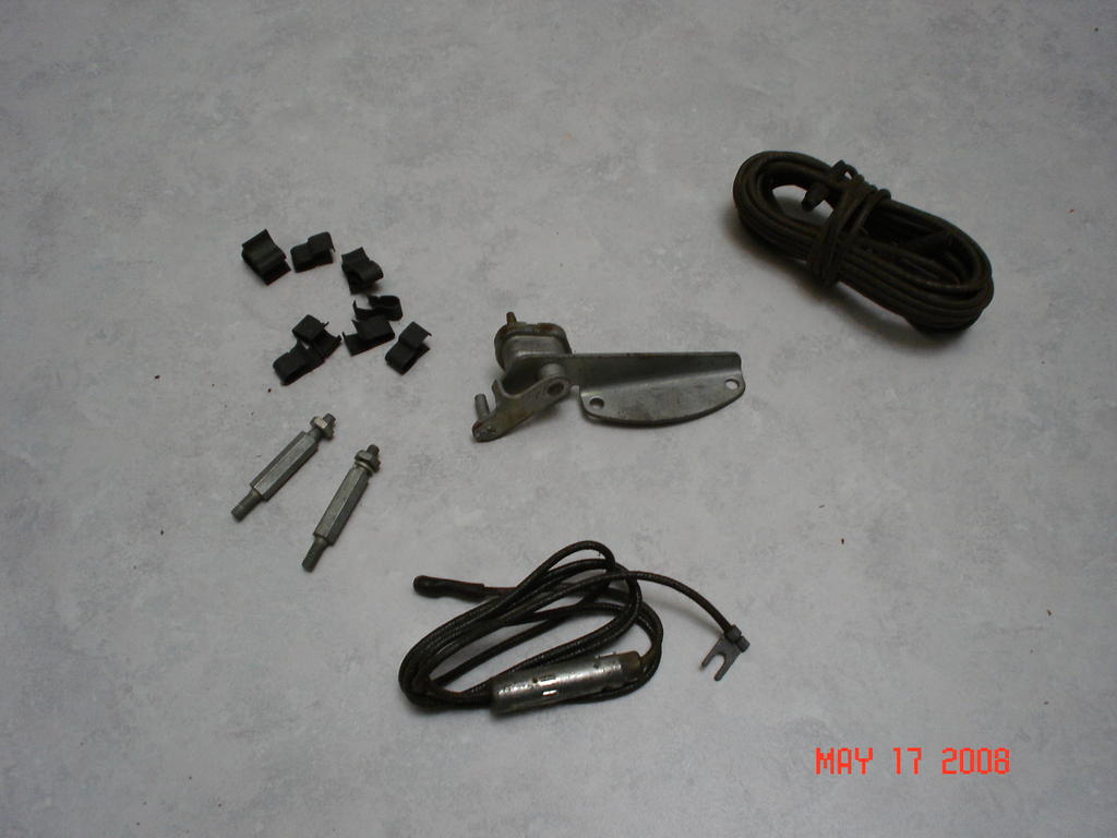

  11. Kens 50 PU
    Back up assembly for chevy cars
    This is what was used on passenger cars when back up lights were used. The switch was attached to the gearshift housing on the steering column.
    I know this doesn't work for floor shift trucks, but I don't see why it wouldn't work for a 3 on the tree.

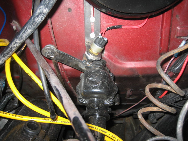

  12. coilover
    coilover Member
    Mar 30, 2005
    2,564
    Plano US
