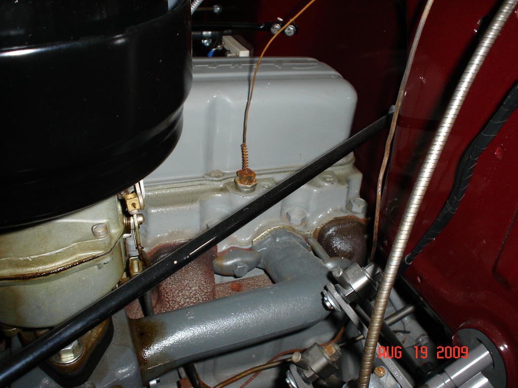

    Here's a picture of what Bill is speaking of. I think it's a good idea to install a valve here to shut the water flow off to the heater, otherwise it gets a little warm in the cab during the summer. Just my 2 cents.

    The valve Ken is using is available through Carter's. It is pricey at $39 :mad:or so. It takes about ten minutes to install once you figure out how to get a wrench on it in the tight space there on the block:eek:. Works nice and looks almost original. At any rate if you wanted true originality you haven't messed anything up, and could remove it in short order.

    Ken's valve is in the wrong place , it needs to be on the upper hose else it'll radiate heat through the hose and heat the cab up all summer .

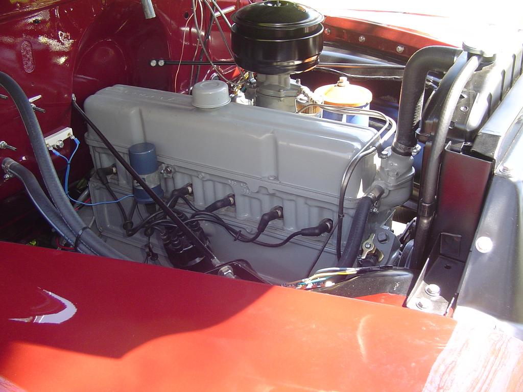

    I Have To Wonder :
    Is there any OIL in that engine ? it's supiciously clean ya know :D
  14. Kens 50 PU
    Of course there is! It hadn't had time to drip on the floor yet in that picture!:D I took that picture right before its inagrual shake down run. Notice how purdy that rottenchester carby looks?
    Check it out now.
