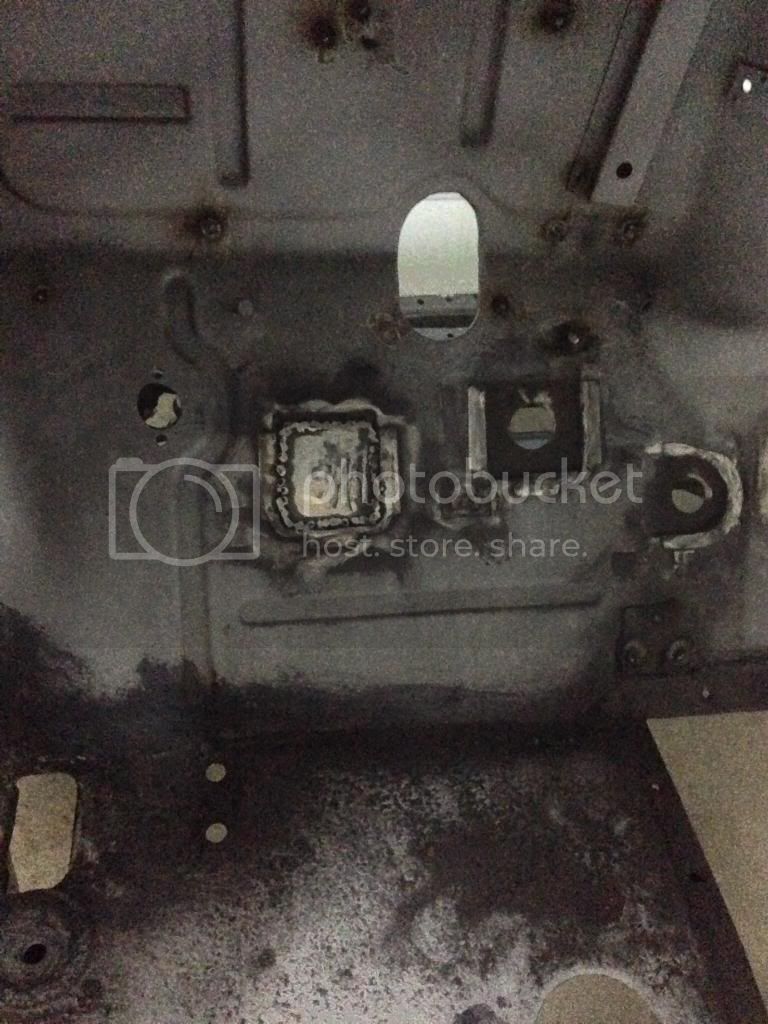

    Just wondering what you guy's are doing. I'm putting a V8 in with an auto trans so I welded up the clutch hole and plan on welding up the gas, but what about the brake? I already cut the top plates off everything and now I'm wondering if that was a mistake. I notice classic parts does not sell a grommet for the hole just some sort of seal that went between the the hole an to plate. So what are you guy's doing with your setup, brake and gas? Pictures would be nice. Thanks

    I have the under the floor model. I made a bolted access panel in the floor, checking the fluid level is not difficult by any means.
