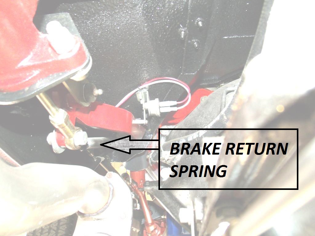

    Hey Zig. I'm not sure exactly what piece of 5" metal you're talking about. Here's a picture of my chassis on the driver side, with Master Cylinder installed. Brake arm shows, and in front, attached to inside of chassis is a U shaped metal strip with holes in each end which I used to attach return springs for the brake and clutch pedals. See if this helps. Bill B.

    Bill, you are on the right track!
    What I am needing to see is what is used to span the gap from the arm(s) to the u shaped bracket.

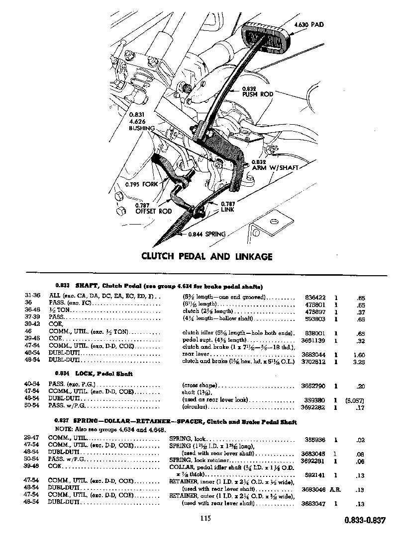

    Tubby, that is absolutely what I needed to see! Measurements and all??? Perfect!!!

    Well~ Apparently I need a clutch pedal return spring now. The one I thought was the spring will never stretch as far as it needs, let alone any further.

    Well, that is absolutely *not* the spring I had saved thinking it went on the clutch arm... And, I don't remember seeing one that resembles that.

    CLUTCH PEDAL PULL BACK SPRING
    27-54 MPC Group 0.844, #3653144 (6" length X 50 coils)
    47-54 FAM Sect 6, Sheet 4.00
    BRAKE PEDAL PULL BACK SPRING
    MPC Group 4.827, #3698665 (30 coils, 5" free length)
    FAM Sect 5, Sheet 2.00
    BRAKE PEDAL PULL BACK SPRING EXTENSION
    MPC
    #3683931
