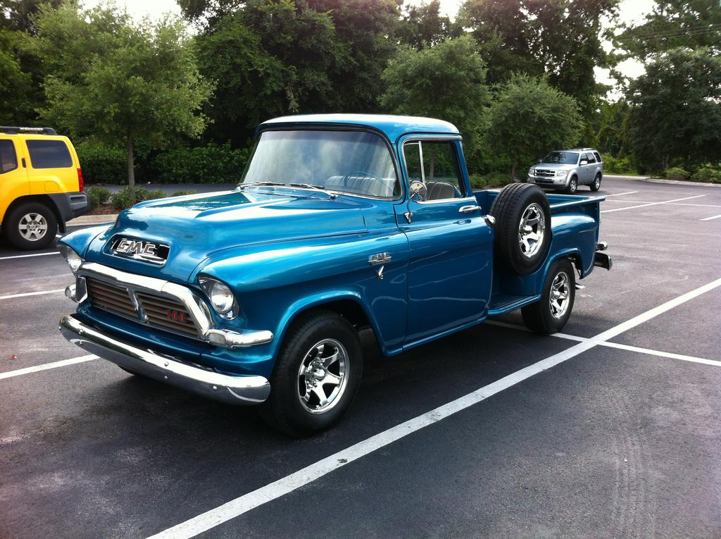

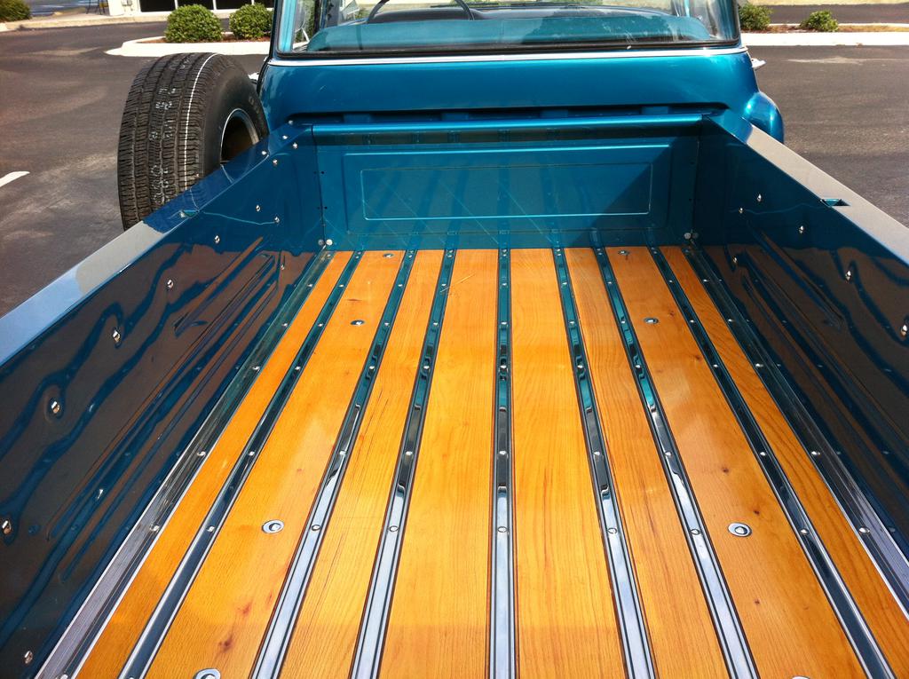

    Your truck
    I like the color, actually I like the whole truck.
    I am not real familiar with GMCs, I want to ask a question, are GMCs front bumpers like Chevys and can be bolted on upside down? Once I put mine on upside down because my helper (wife) did not follow my directions and I was lying on my back and was only concerned with bolting it on, as soon as I stood up and said the appropriate words the bumper was installed properly.
    Seems like there was some discussion on this subject on here several months ago.
    Gerald in Florida (Ocala)

    Tom, There, might be the issue with mounting the bullets! your bumper is on upside down!
    forgot to say,Nice Truck!
    Allen

    I think Gerald is right Tom, your bumper is on upside down. Next time you read the instructions and have SWMBO do the wrench work. GMC and Chevy bumpers are identical except for the two (?) extra holes on each side to attach the bumper guards.
    Here is the best picture I have of my 57's front bumper prior to the rollover last October.

    Awesome truck Vigilante.
  10. ccharr
    Great looking G. and great color.
    Thanks for sharing the photos.
    Charles

    Yes, the bumper was on upside down. I guess we share the same wife. lol
    I corrected it a week after these photos.

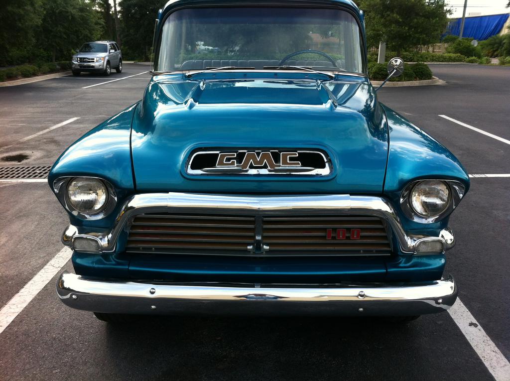

    After looking at your bumper, I believe mine is all wrong. It must be a fake. I will do some more hunting. In the mean time, here are some shots of my Hood ornament and the Bumper Guards. Maybe there wrong too.

    Pretty sure that is a 58/59 hood bird. Looks NICE!
    Do you have a picture of the out side of the bumber guards?

    The T in your serial number specifies 1957 model.
    I agree the 58/59 hood bird is better looking than the 55.2-57 hood bird.
    Those appear to be the correct 57 bumper guards to me, but I'm working strictly from memory.

    gmc bumper
    there are 2 extra holes in the bumper
    Just next to the square holes for the bumper bolts as you can see on the chrome bumper
    But BE AWARE there is a difference as you can see on the sandblasted bumper
    the bullets are wider apart on the 58-59 type gmc's
    the bumper bullets are narrower on the the 55-56 type gmc's
    As far as I know ?!?!!?
    I hope this will answer your question
    Nice truck and I love the hood ornament
    It's 58-59 hood ornament
    It doesn't have the vertical bars in the engine inlet
