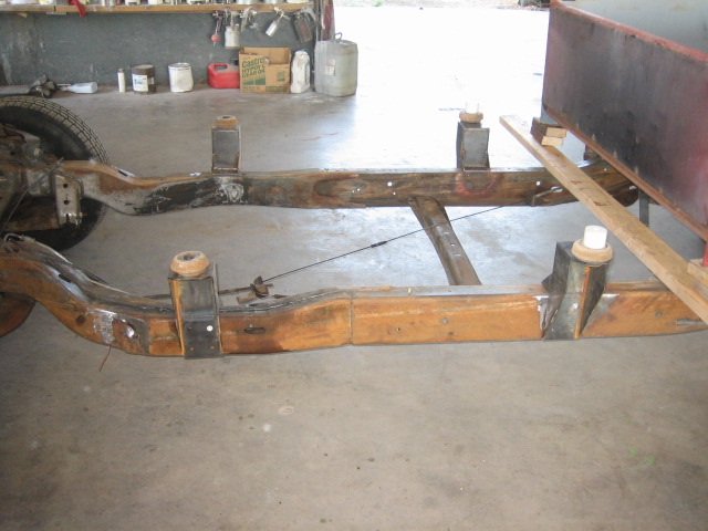

    Andy, I know you asked the time and this is like the history of clock making but it might be something one could use in the future. This is a pic of the cab mounts from the A-D Engineering S10 frame swap kit. They are taller and bigger overall than what one would use to replace the shackle type factory mounts but something along this line would work. They bolt to the frame (ones shown just have one temporary sheet metal screw) and the white polypropylene spacers on the rear mounts can be trimmed to level the cab. The S10 rubber biscuits isolate a lot of road noise. Actually pretty clever. What Nate said is so true, these trucks were in a time that people had been cut off from everything by WWII and had money in their pockets. Fertile ground to gin out vehicles with flaws cause they were sold as soon as the last bolt was semi-tightened.
