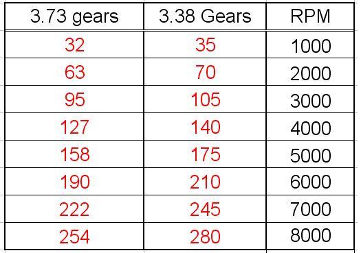

    Looks like a workable combination to me.
    3.73 vs. 3.38 rear gears... makes very little difference in the usable RPM ranges.
    Your question about too little power is a good one, not sure the motor will have enough HP to cruise in OD. But that's the beauty of the T5, just shift down and your good to go, literally!
    Data below shows MPH based on 0.73 ratio fifth gear and 29 inch tall rear tires:
    Data below shows MPH based on 1.0 ratio fourth gear and 29 inch tall rear tires:
