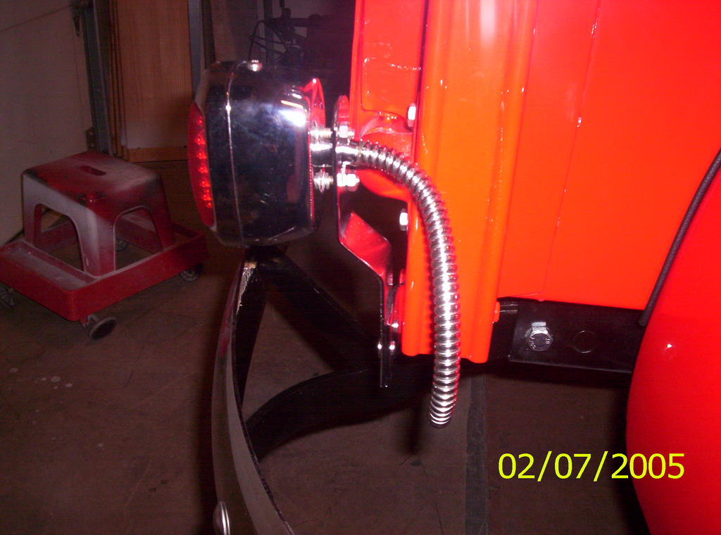

    001.JPG Hey Greg I hope this Pix helps, the conduit just slides over the rubber and that's it. Notice the clip bolted through the mounting bracket. Not much to it. I hope this helps....Big Tim:cool:

    Big Tim
    Your truck must be a '54 or '55.1. My taillights are the more rectangular ones on the 47-53s. They don't have that rubber boot in your picture.
    I can see how this conduit would work on your taillight, so I'm guessing our host was not specific about which models the chrome conduit would work on.
    Thanks anyway.
    Greg

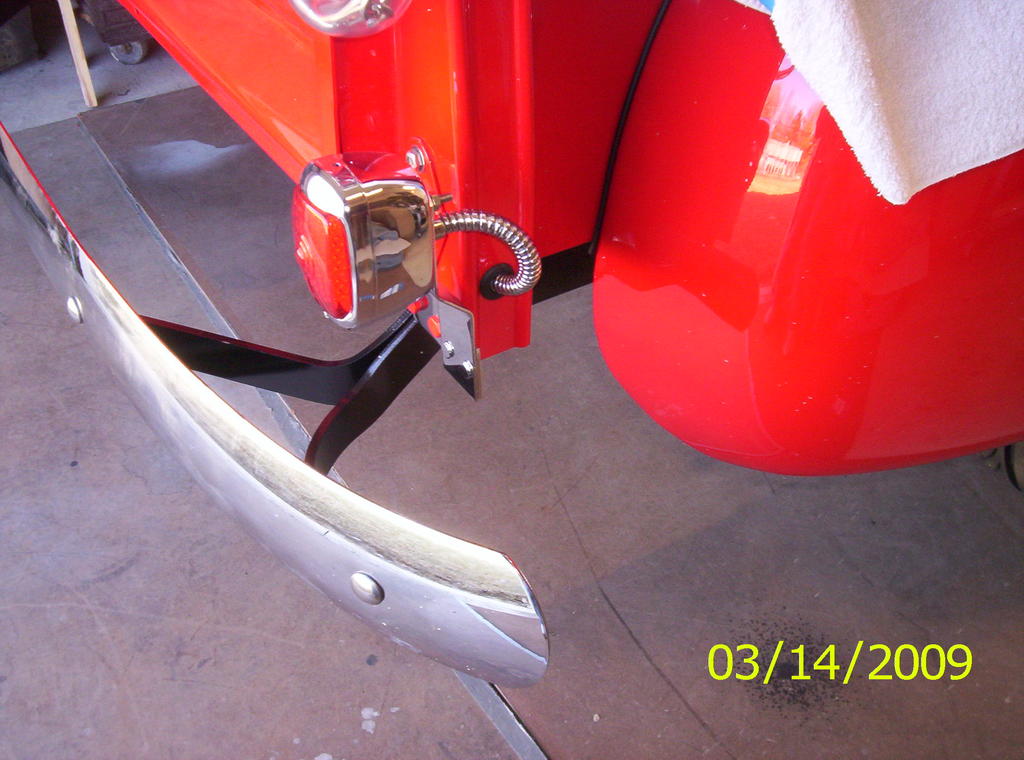

    100_0353_00.jpg 51 pick up 017.jpg hows this look

    Extra holes?
    You photo raises another question? Did you drill the hole in the rear stake pocket?
    I thought the conduit just went under the side panel through the hole in the frame rail. You installation definitely looks nicer and cleaner, but I don't think this is factory original. I don't have any holes in the side of the rear stake pocket.
    Greg
