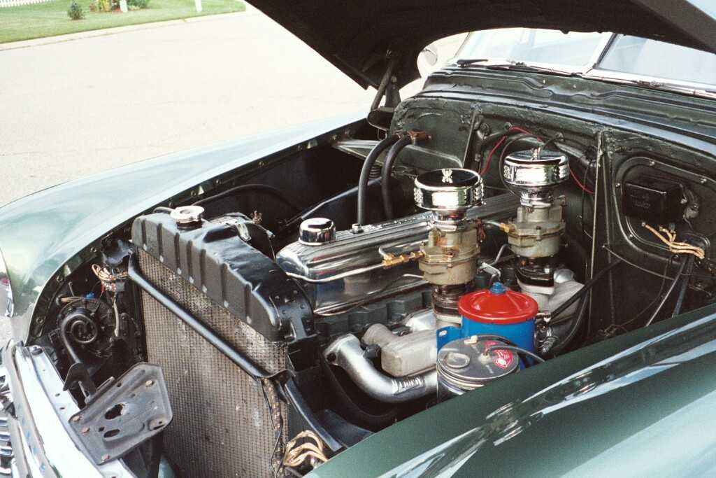

    For what its worth...I put two Rochesters on my fenton intake. It has a manual choke set-up on them so I used them. The choke cable is on the rear Carb as in a stock single set-up.
    It is not cosmetically pleasing at all as the cable looks bunched up on the firewall because the rear carb sits so much further back on the manifold. I think you will be happier with your auto-choke set-up as Nate describes.

    I also can't find a nice place to put my glass bubble type fuel filter. I wanted to show it off and make it easy to see. I have not found a good spot for it. You know how much we pay for these and to not use it really bothers me. It looks great on my single carb set-up in the 47'. But the dual carb setup precludes using the same spot. Any idea's.
    Flashlight
  9. Kens 50 PU
    Couldn't you put one on each carby on a 45 degree angle and hook up the fuel lines to them that way?
  10. vwnate1
    Glass Bowl Fuel Filters
    What Ken said ~ if you peruse pictures of various dual carby setups , you'll see how they manag it with angled fittings .
    You can use the dual feed pipes from 4 BBL Carter carbys on dual single carby setups to make tem look nice .
