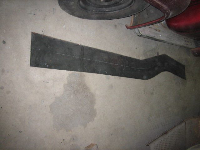

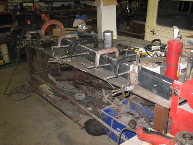

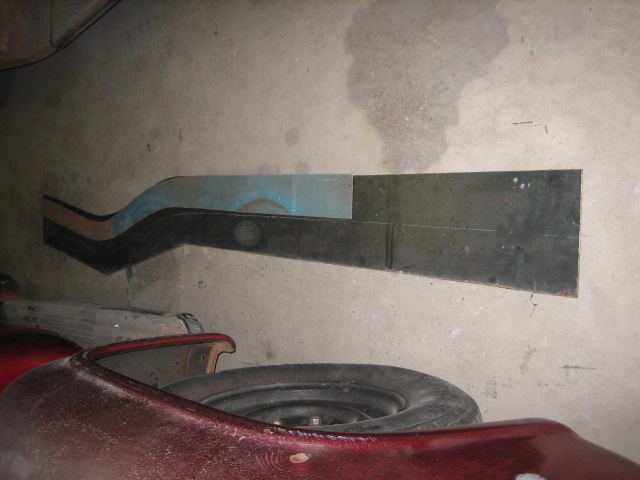

    We first cut the frame profile onto a piece of 1/8" masonite to act as a plasma torch guide. The front and rear kick-up sections are cut out of either 11g or 10g cold rolled steel plate. The center section, if straight, has a 2x6 section of rectangular tubing the same thickness as the end sections. All joints have an inner plates that can be plug welded after the outside of the rails have been butt welded. The joints are then the strongest part of the frame. If the rails curve then all are plasma cut from flat plate cause it's darned hard to bend 6" rectangular tubing while flat plate before boxing is easy. The inner and outer rail plates are aligned and clamped together so a series of 5/16 holes drilled through them are exactly in line. Now 3" long all thread is run through these holes with two nuts on the inside and two nuts on the outside. The inner and outer nuts are adjusted till the top and bottom of the side plates are exactly 2" apart. A two inch strip of strap is used to box the top and bottom. Also use 2" blocks and C-clamps to cut down on warping. After the all thread spacers are removed everything inside can be shook out of the end. For the rounded "factory" look we cut 1/8" rod into 2 1/2 inch lengths and put it between the two inch boxing strip and the side rails. Two passes are made with the mig with one being a 100% penetration pass and the second being a "bondo" pass. This last pass is just a build up that can be ground to the desired radius. I made a mig torch guide so very long beads can be run that are where they should be and are so smooth grinding is much easier. Between my fading eye sight and shaky hands the latter was a necessity.

    Very interesting hand crafted frame. I think I understand the process. I'm guessing this would take several man-hours to complete.
    I wonder what kind of investment it would take for a machine like Art Morrison has, capable of "hard way" bending rectangle tubing.

    Nate, you have eyes like a hawk, it is a 1934 Ford pickup.
