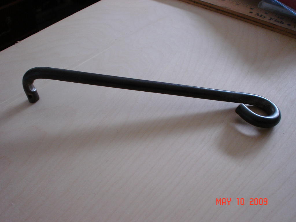

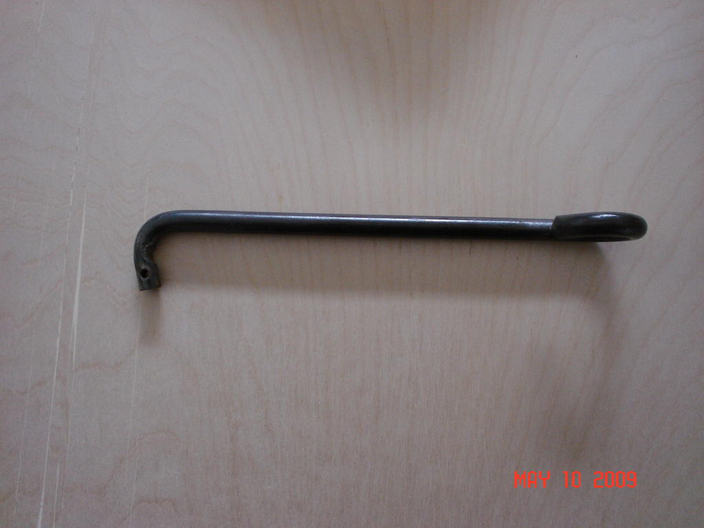

    Mike, before I send this to you, check the wear.
    Hey Mike, here's a couple of pics of the linkage. It has some wear on it, so take a good look and see if you think it is acceptable. The price is right (free), but let me know what you think. Anybody else feel free to chime in as to whether or not you think it is acceptable to use or if it is too worn.
    Ken
  8. vwnate1
    You can easily have that worn part welded up and file it smooth then heat it up cherry red and toss it into a bucket of cold water to re-harden it so it won't wear fast again .
    If you use it like this , it'll have a stiff clutch and maybe jerky action .

    Even with the wear it should work fine. Nate, I was trying to weld it up, and as soon as I hit it with the mig wire, POW! The whole right angled end just popped. It was very odd for sure. My thoughts are that even with wear on it, it likely is better quality than new repop ones, and will still outlast them. Thanks.....Mike
