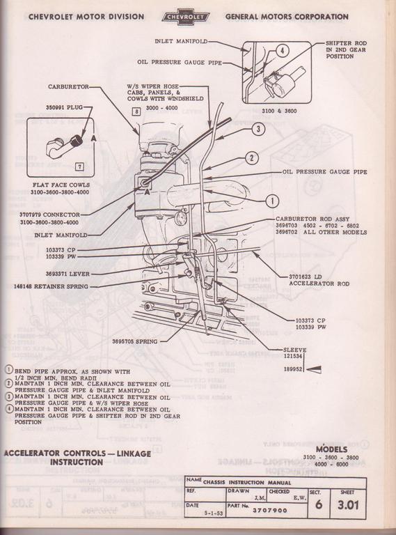

  5. Kens 50 PU
    Here's a diagram from the factory assembly manual that shows a typical linkage hook-up. In this case, it's most likely a '54.
    Hope this helps.
    Ken
  6. wokri
    wokri Member
    Jul 14, 2008
    325
    Germany
    Many thanks for the pics :))
    Hello guys, thank you for your substitute. I think it will helps!
