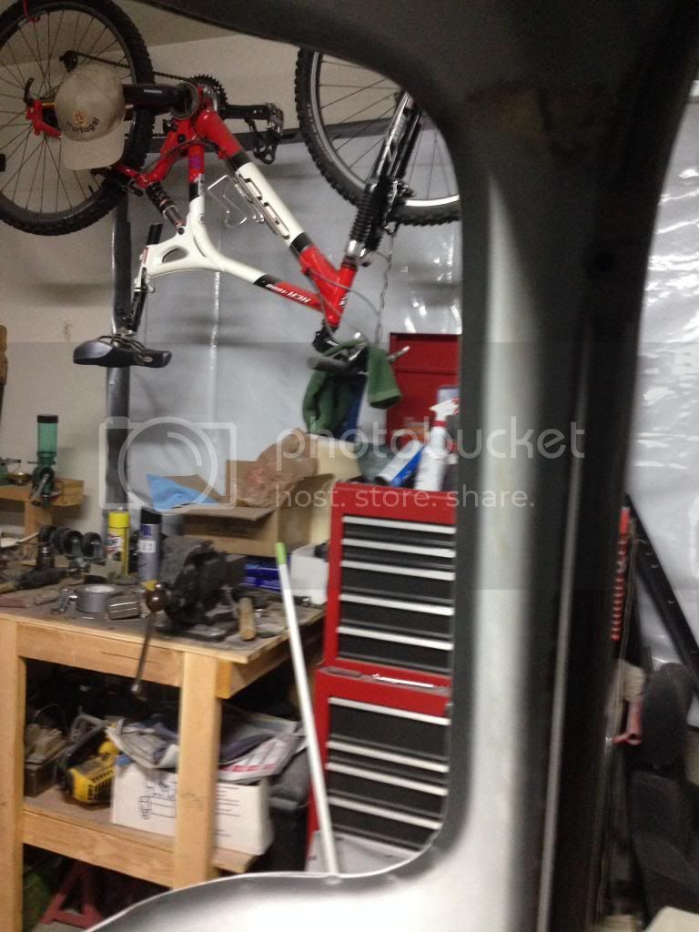

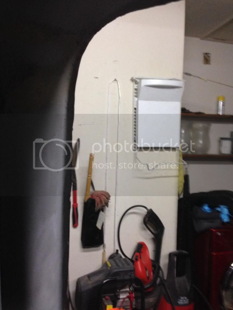

    Hello, tonight I was looking at my corner windows and notice on the passenger side the two pieces of metal did not line up like it did on the driver side. I took my grinder and grinded the piece down to match the other one. After doing that then I notice on the driver corner window had a lip on the inside about a 1/2" and the passenger side now had about a 1/4". Of course I notice this after I grinded it down which explains why one piece of metal extended farther out than the other. My question is did I mess up and do I need to weld a small piece back in. It's towards the door from top to bottom of the corner window. Don't know if you can see the difference in these pictures or not. The one with the tool chest is the driver side and the other us the passenger where I grinded it.
    Just wondering how much of a lip on the inside do you need for the rubber and glass to stay in place? Thanks

    I think you'll be okay as that this window is curved and you still have the top and bottom lips to help hold it in place.
