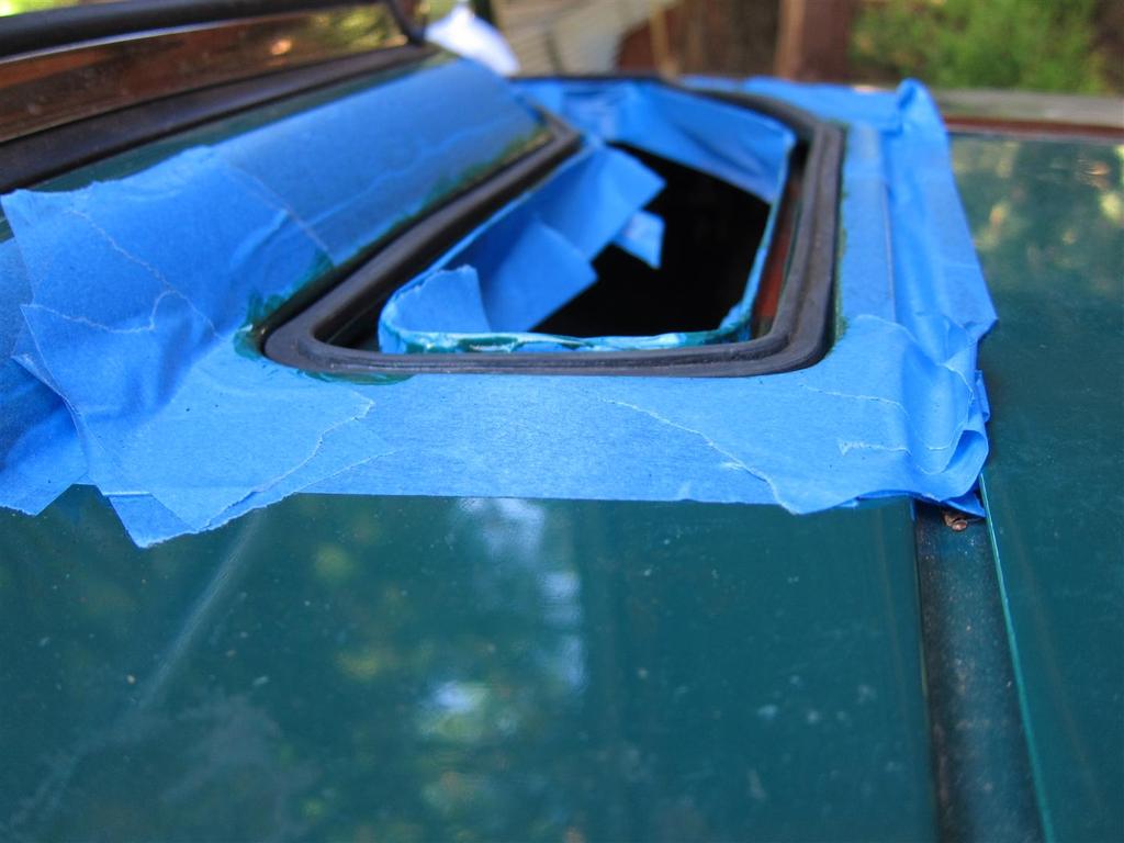

    Cleaning up the cowl vent area
    and looking at the vent gasket. Does it install the way it is in the picture? Or is it upside down?

  2. Blueflame236
    Blueflame236 Member
    Mar 29, 2008
    1,555
    Norway
    Cowl vent gasket mount.
    The gasket wich is shown in picture nr. 1 is the right posistion.

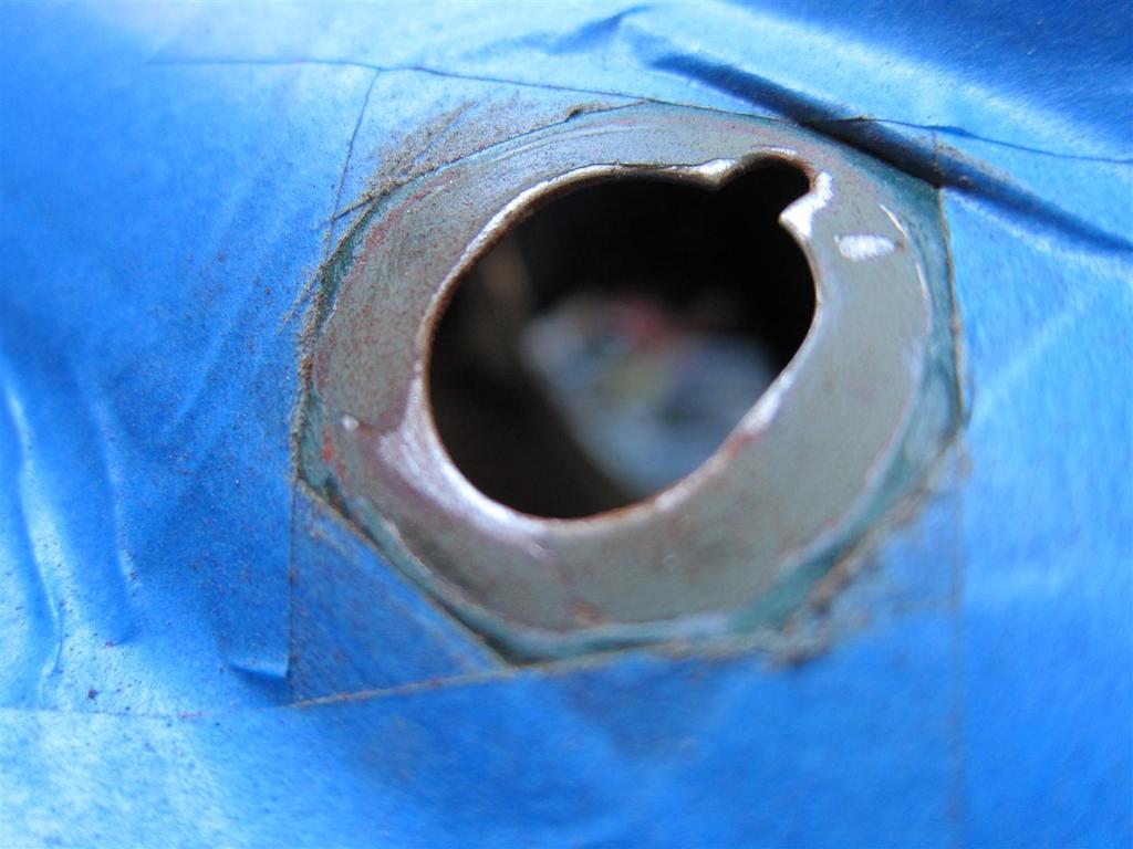

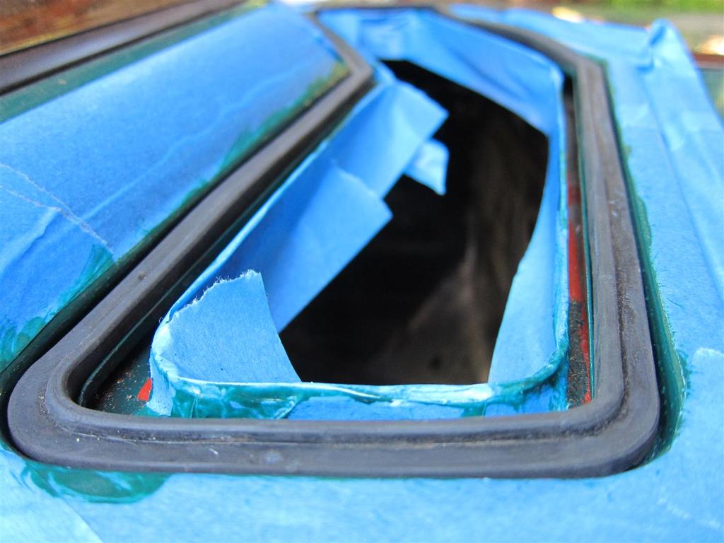

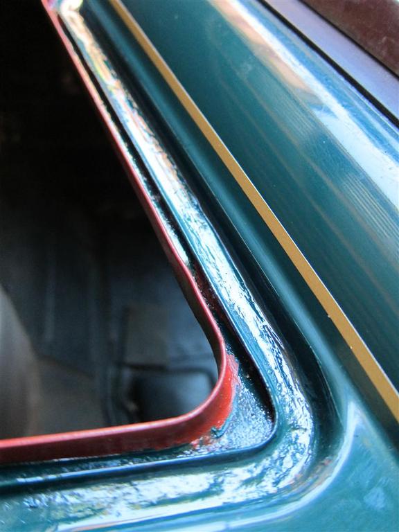

    OK I cleaned up the channel that holds the gasket. I taped off the entire area around the cowl vent. I folded sandpaper and carefully removed the old paint and rust. I then primed the area and once dry (several days) painted it.
    I then test-fitted the gasket. I am using the solid rubber one as opposed to the foam. I immediately noticed that certain areas of the channel were slightly higher and narrower that the rubber gasket. ALSO the rubber had left over flashing that wasn't cleaned off when manufactured. I used sandpaper and both removed this and also narrowed the sides and bottom of the rubber gasket.
    I then rechecked the fit.
    While working in area, I took care of the unpainted wiper shaft area. The PO when painted the truck simply masked the wiper shaft area instead of removing them. Again I taped, primed and painted the area.
    Once I have finished the under dash area (de-rust, prime and paint) I will check the final fitment of the cowl vent.

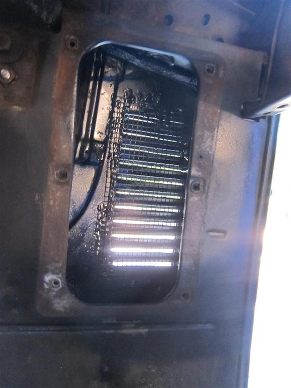

    While under the dash (sounds like a title to a movie!) I also cleaned the heater air intake area (ahead of the right door, behind the right front wheel) and then installed 1/8" wire screen to keep insects out.

    Looks like you did it up right, Haasman. I'm sure you used more than the tape when you painted the exposed areas. Looks like new windshield rubber as well!
