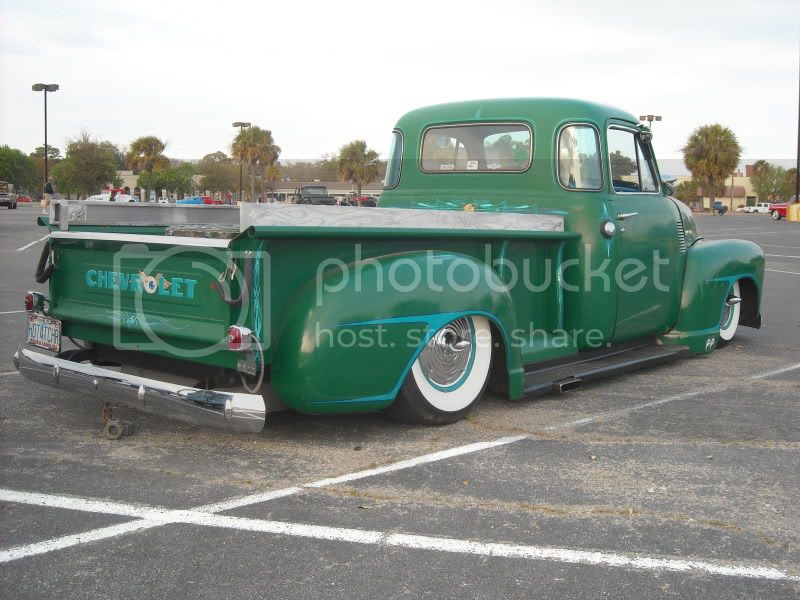

Thats all in the air suspension, Zig. It has a quite a range of travel with the air bags, so you set the upper ride height, and with the IFS replacing the stock front axle, it will drop down to that level.
Yep, now that's a low setter. I hadn't noticed before that it sets so low your nuts are draggin'. How do you like the handling of the air system...do you see a difference from springs? Is your system set up to adjust front and rear separately, or each wheel independently?
Mine is set up for front and rear, then seperate switches for each wheel. I love the air. When you get the alignment done, set the air at ride hight or just a little lower, to compensate for some pressure variances. ALWAYS seperate each wheel, otherwise you may get air transfer in the corners and adverse body roll. I highly reccommend sway bars front and rear also. As far as handling.....
That's pretty cool, chebby. I thought the individual settings would be good, as it seemed if they were common side to side you might get more air transfer and roll. I'm anxious to drive this one and see how it handles...
