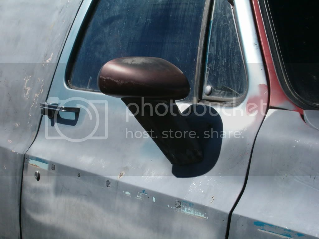

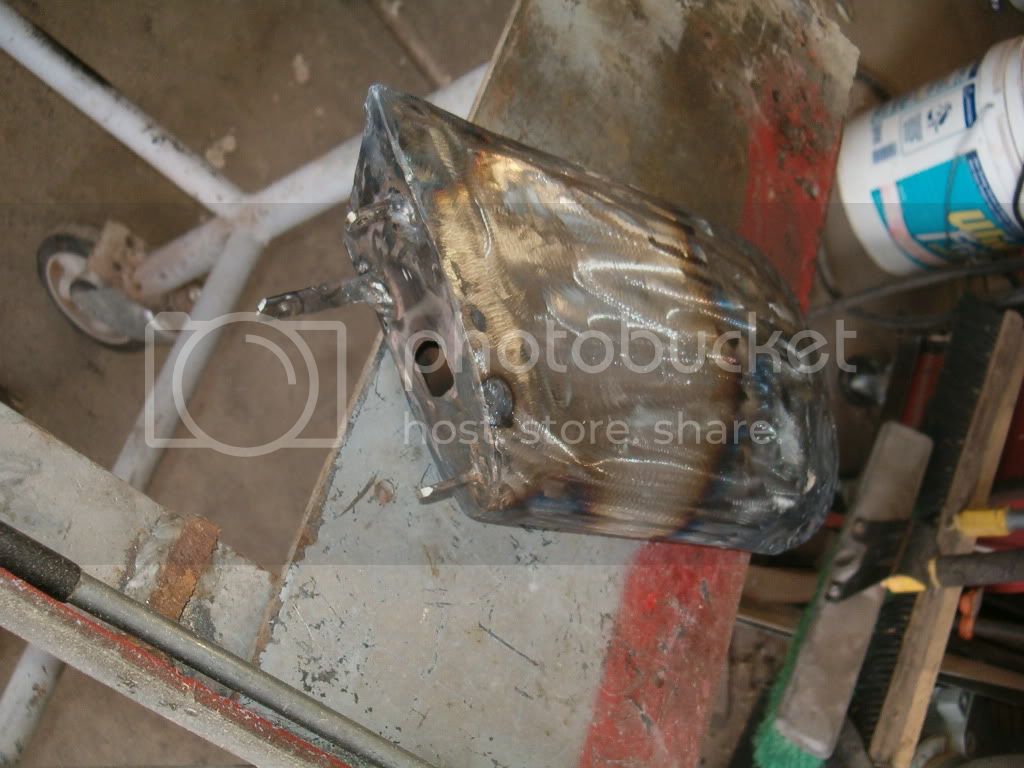

    I stared with 1991 Chevy Caprice Power Heated Mirrors. and this is what I came up with;

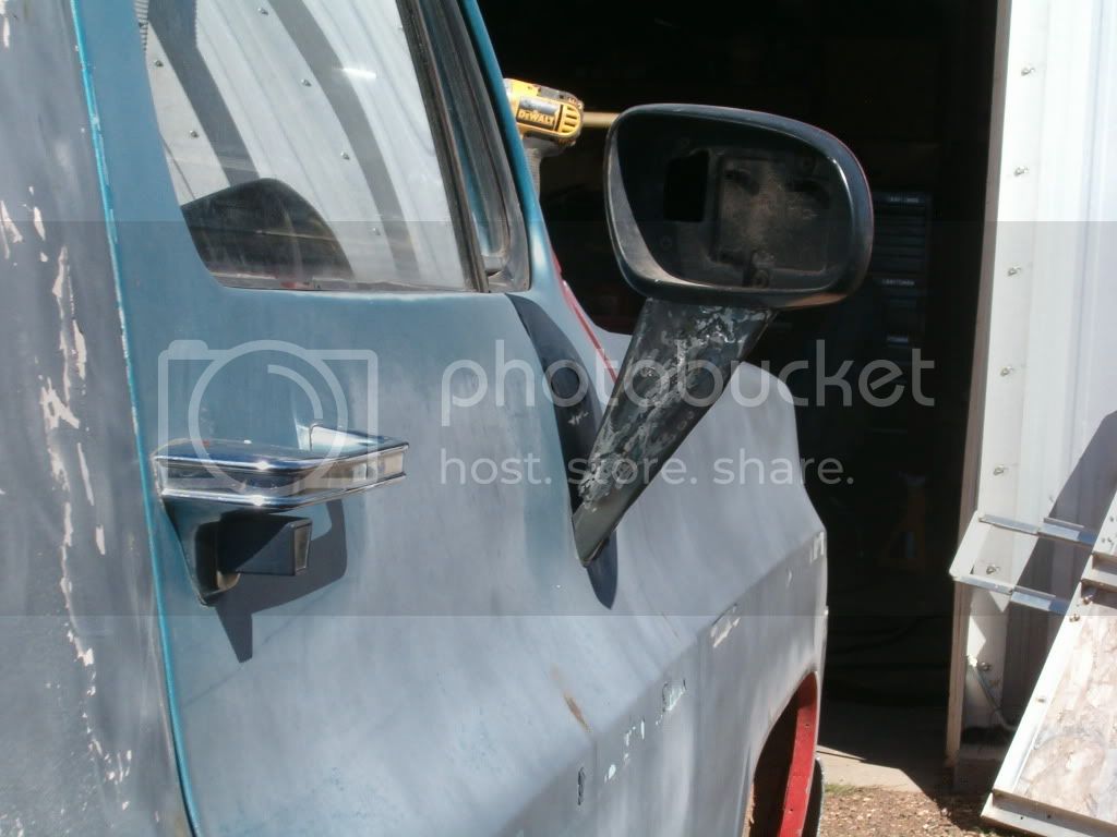

    I had to extend and move them out from the door so the wing windows would still operate. first fab.
    now to duplicate to drivers side.

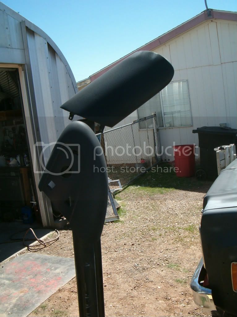

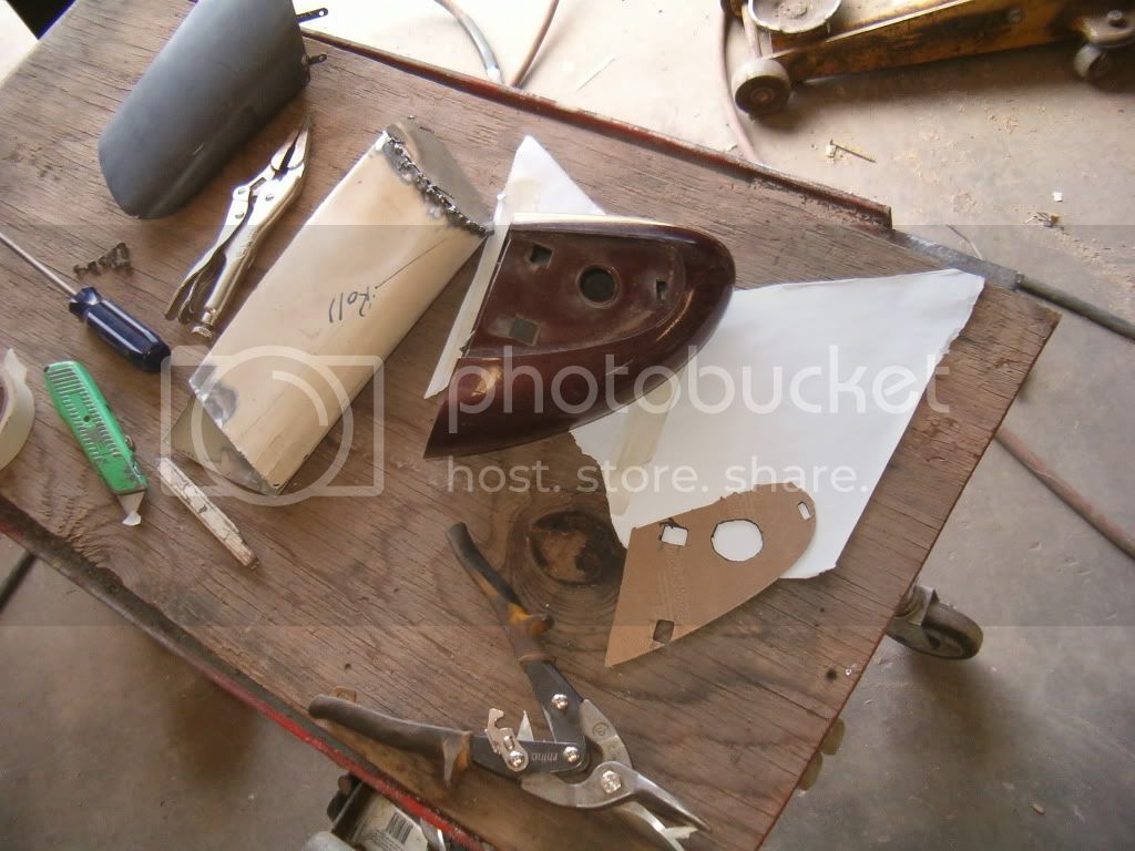

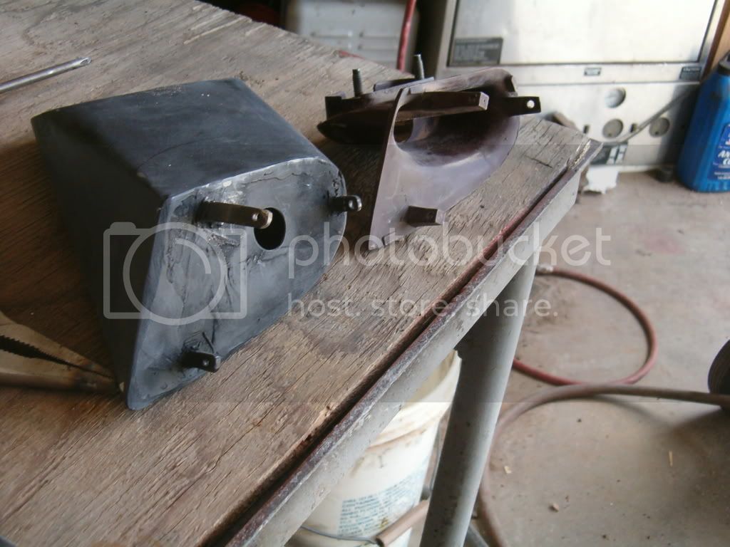

    a little re-shaping. and add mounting tabs.
    here is the factory Caprice bracket for comparison.

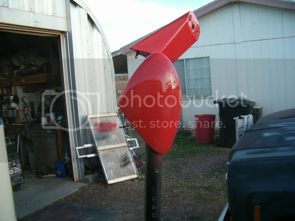

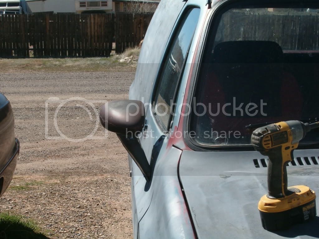

    Prime paint install

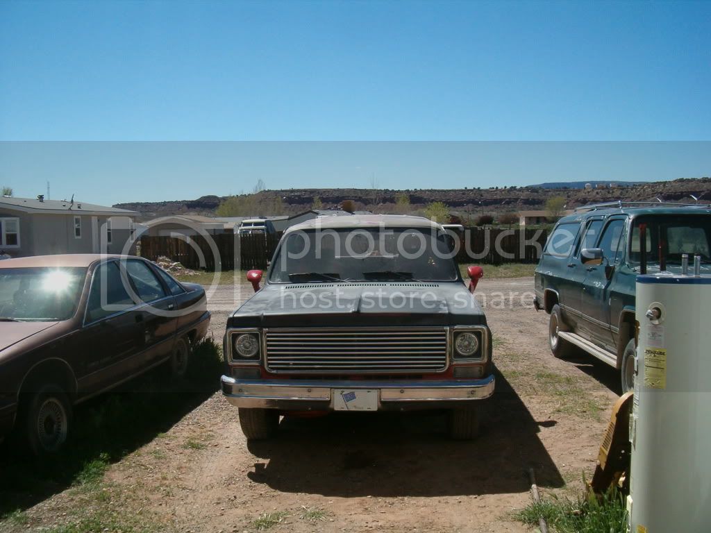

    I was after a factory look I think I'm close.:D
