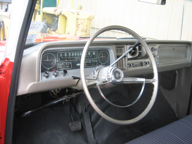

    Really great work. From the pic it looks like you got rid of the clunky looking parking brake lever and even preserved the stainless VIN tag. One blast with any kind of media, even soda, and these things are toast or at least crappy looking. Dash is updated without altering original lines. The plating on the factory a/c diffusers looks new and good. I have a hard time getting them plated without getting yellow areas in the corners. Good job.
    Here's a stocker so folks can see just how much you've done.
