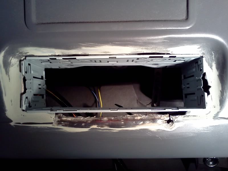

    Sorry about that. Here we go. I thought that maybe one of them billet bezels would cover the mess but, well, I will let the pictures speak for themselves.

    What's the theme of your truck? By that I mean are you wanting the end result to look bone stock, or just not to look butchered up?
    I would think as long as you aren't wanting a stock look you could indeed make a bezel to cover the opening. You'de still need to add a bit of body filler though to the lower portion of the dash.

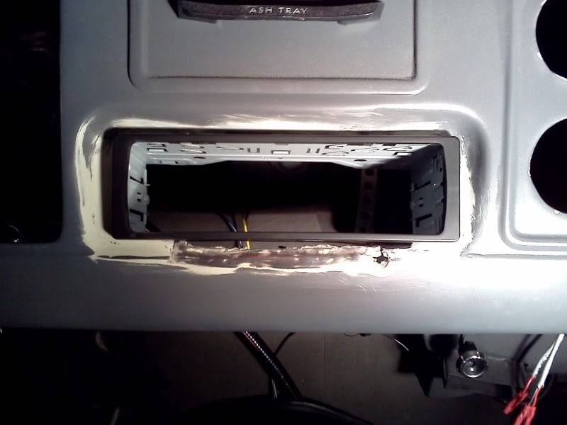

    John, I fooled around with the dash some more today. Here is how the 'cage' fits in the hole.
    And here it is with the black plastic trim.
    As you can see, it doesnt need very much of a repair. Only a little on the left side and top and then the bottom is the worst spot.

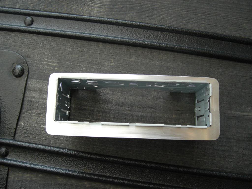

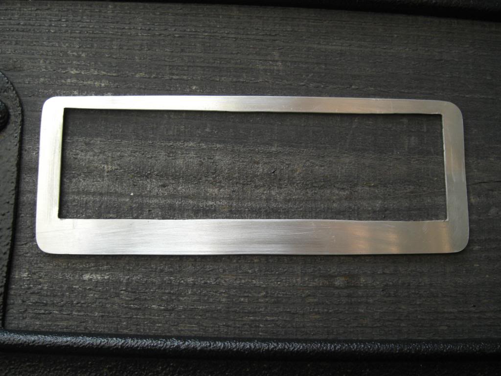

    Ok, here is my attempt at this bezel.
    I picked up a 5x10 piece of aluminum for five bux at my local reynolds true value. New set of jig saw blades for three more bux and brought it home.
    I made a rough template out of carboard and covered the aluminum with blue painters tape. Drilled some holes to get me started. The hardest part is keeping your cuts straight. If i had given it more thought, i would have made a jig for it or something. I did lock the aluminum down with c clamps. Lots of test fitting and filing down by hand.
    If i could change something, i would have made it out of thicker stock because it really needs to be thicker at the top and taper down due to the contours in the dash but for now, problem solved.

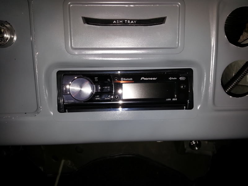

    well, I owe you a current picture with the head unit installed and everything looking good or at least good enough! LOL. The paint matched pretty good and the bracket I made is hardly visible in the picture but it's there!
    Here it is.
