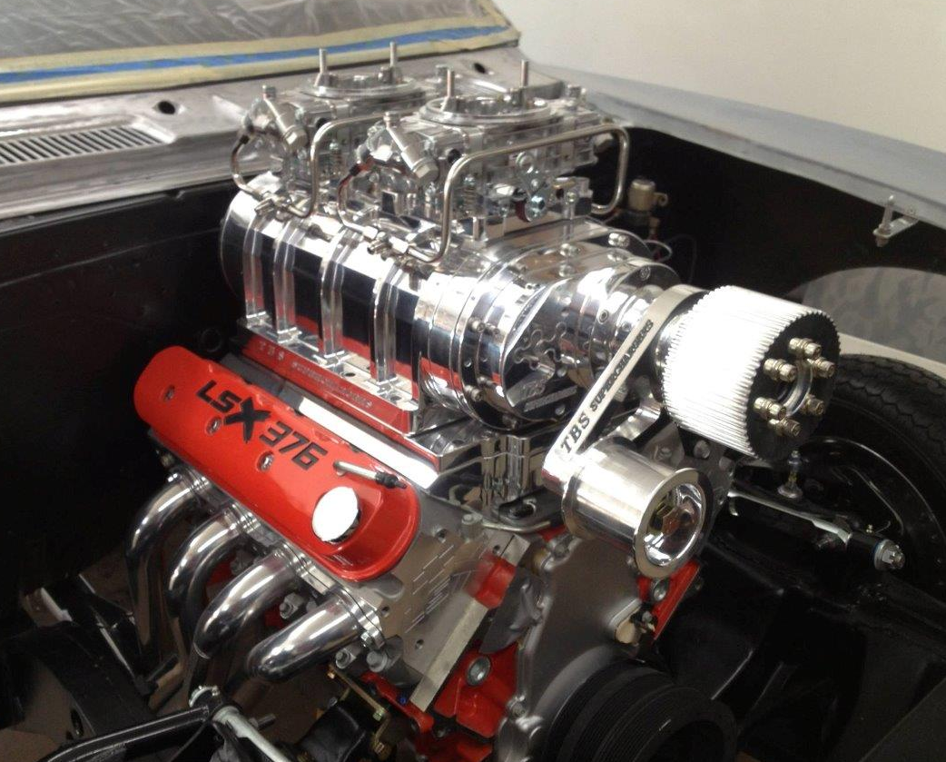

    Yeah, John, V-8s in old pickups all look short and wide. Undesirable in, well, a lot of things...
    Here are a couple of remedies, I've thought of.
    Steve.
    I'm guessing this one would be hard to get to run right at 8000 feet.

    Nope.. It's just a matter of changing pulleys. They sound a lot better... when they are spinning faster. :)

    That blown engine looks to be designed for some serious boost since they went with an iron block. Also like the idea of a bigger blower that doesn't have to be overdriven a bunch; it keeps the temp lower than a small one spinning faster. Still gives that beautiful sound.
